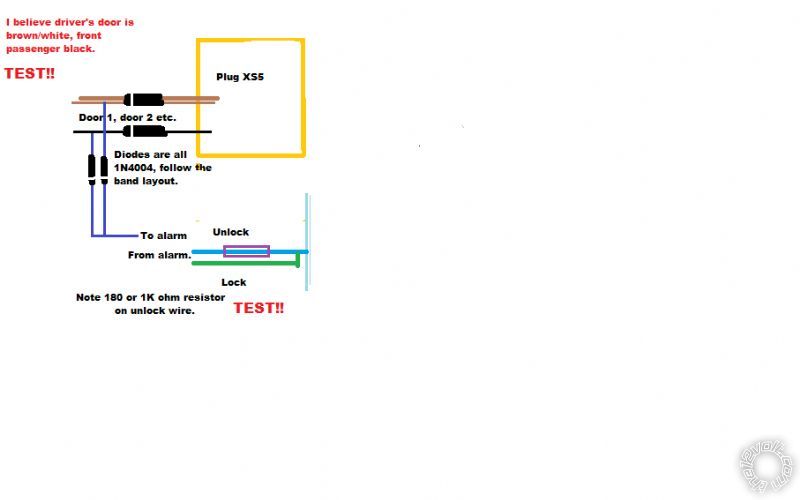

Look at this:-
To test lock/unlock, ground the wire (with the door's rear latch pulled over, this will lock the vehicle.
Then, ground same wire via 180 ohm. This should unlock, if not try a 1 K ohm.

Posted: April 20, 2015 at 10:47 AM / IP Logged Link to Post Post Reply Quote chassis
Thanks a lot Howie!just something I would like to know,the resistors do it have to be exactly 1K or 180K resistors.and what could happen if the resistor was not on the unlock wire,just for my own interest.yes I do have on board relays 6wires,so that's also a bonus for me.
Do it once,do it right - This means no short cuts. You never get paid twice for having to do the job twice because it wasn't done right the first time.
Posted: April 20, 2015 at 12:05 PM / IP Logged Link to Post Post Reply Quote howie ll
20% error but those are standard values, any electronics store/TV repair will have them, 1/4 watt.
If not on unlock wire it won't unlock.
