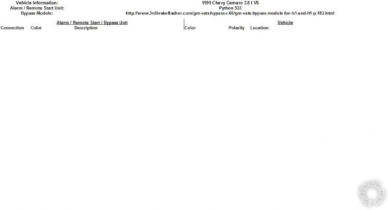

Been searching for awhile.
Just want to Be sure Im doing this correctly.
Still Kinda iffy on the "Relay satellite4-pin connector" "status output connection.
Found a few things on the 1999 V6 camaro. But info for the Python 533 from Directed Electronics is pretty slim.
Here is my template. Ill get back online late tonight and tomorrow morning. Thankyou in advance.
1999 Camaro And Python 533 -- posted image.

Hi shaneret,
The picture you posted does not show your connections.
IS your question about the specific connection and its function? because "iffy" is not a good description of your problem.
What sort of issues are you having? what functions are not working properly?
Posted: June 01, 2015 at 2:12 AM / IP Logged Link to Post Post Reply Quote howie ll
Nobody replied because your post doesn't ask anything!
Hence X 2 with icearrow6.
