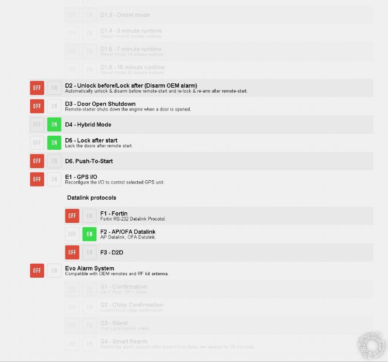

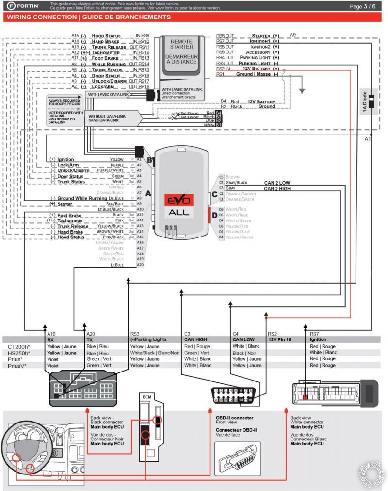

Thank you for you reply Ted, but as I said in the beginning I'm new to this, actually is my first attempt to mount this on a car by myself. Right now EVO-ALL is on AP Datlink/OFA Datalink as you can see in the attached picture. Wires are set like in Fortin schematics (attached). Only solid black on schematics wired. When I power the Compustar, EVO is not receving power through D2D... Do I have to wire all cables? Also the ones with dotted lines in schematics? Is an alarm/remote started that will successfully only the D2D port from Fortin and 2 - 3 wires to get the job done?
