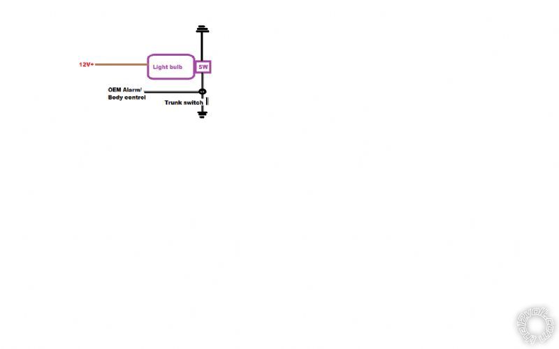

BLACK/ white - Unsure how this one works. When the plug is removed from the assembly, this is 12v+ and the trunk light turns off. If I ground this wire, the trunk light turns on. When the alarm is armed and this wire is grounded, the alarm goes off. With that said, I've attempted to use this wire with the sensor. The light turns on in the trunk when the sensor senses a shock so my wiring is correct as I planned it, but the alarm does not trigger. I'm not sure what I'm missing here. Can anyone assist?

I'm no electronics guru, just want to confirm that it is normal/ok/safe to ground a wire when it has 12v+. It seems normal as it makes my trunk light turn on, but isn't that shorting out the wire which is bad? Or is this normal?
Posted: June 21, 2015 at 12:21 PM / IP Logged Link to Post Post Reply Quote howie ll
If the bulb is left in, that BLACK/ white will show 12V+ until it's grounded.
Here's your circuit:- trunk_light.png
