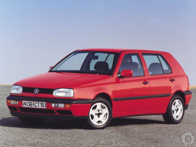

Good day Gents! I have a someone who owns a Golf III,and this person lost the touch key that you put in the dash before the car can start.I am just wondering if the system can be bypassed as some say it can't and the onwer will now have to change to an open ecu to cut out the immobiliser function.I just want to know if someone here have done it already perhaps before I attempt something I won't be able to finish.It has a VW Alarm/Immobiliser module right behind the glovebox mounted to a bracket with a lot of white wires,all the wires on the harness are white. VW Golf III Immobiliser Bypass -- posted image.
