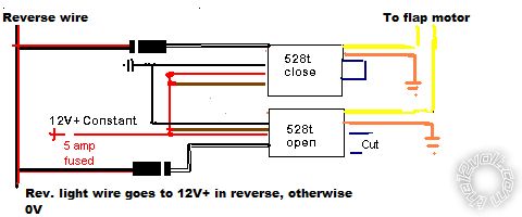

Here's a simple way to do this. Use the reverse (back-up) light feed.
This wire sits on ground, when reverse is engaged it goes to 12V+.
Use a pair of DEI 528t adjustable timer relays, just add 1/2 second to the normal open/close times, no microswitches required.

Posted: September 17, 2015 at 7:58 AM / IP Logged Link to Post Post Reply Quote howie ll
Then use normal relays and microswitches.
