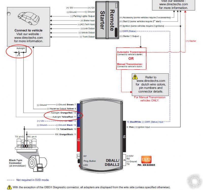

Installed a Viper RS with a DBALL2, followed diagram to interrupt the autolight but autolight still stays on after remote start shutdown. Does anyone have any suggestions or am I missing something? DBALL2 and autolight issue -- posted image.
This was done on a 2007 Lexus GX470, autolight wire is green orange at headlight switch.

Do you know what firmware version is on the db=all? Looks like there was a issue that was fixed a while ago.
"v2.41- Fixed autolamp and DRL issue on key type car"

I have the latest version loaded in (v3.19). I am assuming that this version should cover v2.41's fixes as well? Please advise. Thank you.

Yes it should. Do you have a dmm? The orang/red yellow/red should have continuity whenever the remote start is off but not when it's active.

Are all of the doors closed after shut down?
Possibly, are the ORANGE / red and yellow/red on the wrong side of the autolight wire?
