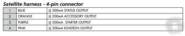

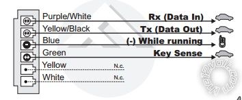

Is this Avital 4103 blue wire the one I connect to the blue Fortin (-) "while running" input?
This installation has been a bear (3 days @4-6 hrs each day) mostly because of the scarcity of information online on the location of most wires, and then poor (sometimes contradictory) direction from most wiring directions. Challenging...And I am a $% Electrical Engineer!
In contrast, the remote start on my 2007 Jeep Grand Cherokee was a snap as it was plug and play, at about 1 1/2 hr!
This forum has been invaluable.
Any help will be appreciated!
