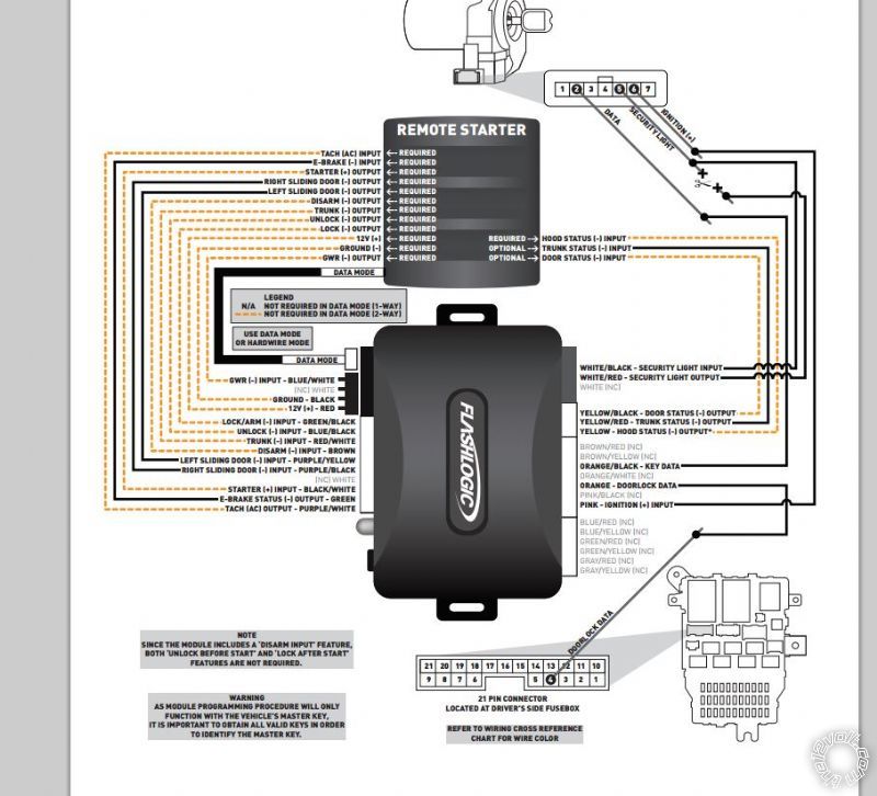

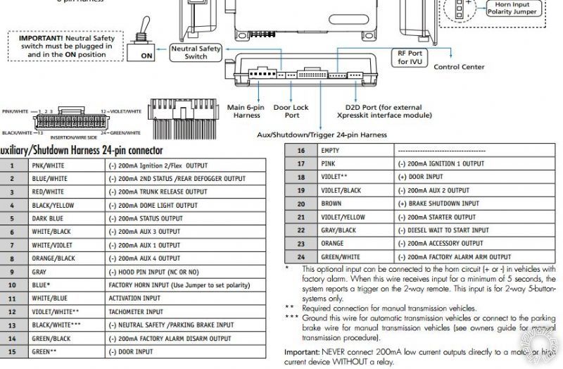

hello everyone,as always thanks for all the help you guys offer here in the forum, it is greatly appreciated.
Ok, so silly question, its been a while since i have done one of these bad boys. but will be doing one soon. I have a 2006 Odyssey with the power sliding doors. in order for my friend to retain those, he needs to buy a remote start with at least 2 Aux, like the one in the pic, and im going to use a flashlogic module which will control everything for me. my question is, do i simply take the Aux1 and Aux2 wires and connect them with the flashlogic wires labeled as left sliding door and right sliding door? or is another set of relays involved? i cant find much info on this and i cannot remember for the life of me.
any input would be great!
really hoping its as simple as connecting the wires from the RS to the module. otherwise this looks like a fairly easy install. unless there are nightmare problems i dont know about.

No relays necessary. It is as simple as connecting the wires directly from the R/S to the bypass module.
Overall average install, I do recall struggling with the transponder wires. It was in a tight area and the wires broke way too easily when trying to strip insulation.

Yellow cake, thanks a bunch. Thought so. I thought I heard those wires were a pain in the ass. We shall see how it goes. Thanks so. I thought we just had to go directly to the flash logic module.
