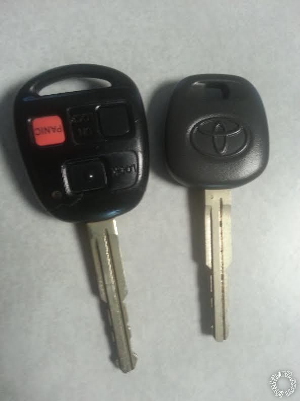

It does have a transponder based system, so I will either need a bypass module. I don't mind the range as I will most likely be using during winter mornings in my pajamas looking out the driveway 2003 Toyota Land Cruiser Remote Start -- posted image.. For that reason, I also don't mind the add-on remote start system as an option.

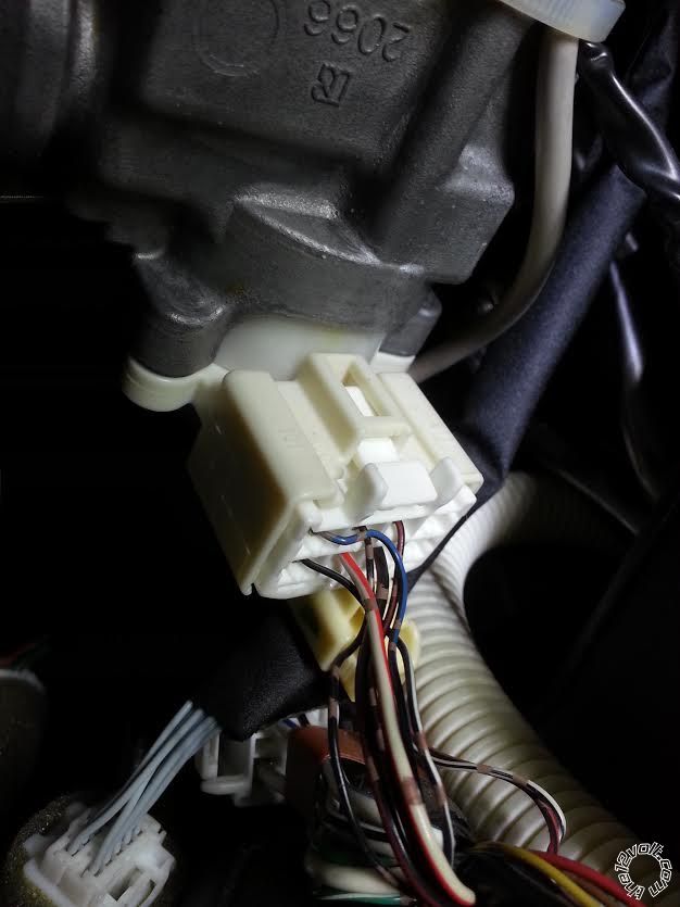

Also, I am not a professional installer but have installed few systems in the past. However, few that I have installed in the past had thick wires at the ignition harness. However, my 2003 LC has all thin wires at the ignition harness... so any wiring recommendations are also welcome.

The other nice feature of the CS800-s system is that if you need extra range or get tired of using the key to unlock the Land Cruiser when remote started, you can always start carrying the CS800-s remotes...  2003 Toyota Land Cruiser Remote Start -- posted image.
As for the thin wires at the main ignition switch harness,  that is getting fairly common on newer vehicles.  You can cut the R/S systems thick ignition output wires ( at 3 inches or so ) and solder on thinner gauge wires for the run to the ignition switch.  You can also combine and fuse down the two Red +12Volt constant input wires.  Take a look at this Pictorial on the 2013 RAV4 :  https://www.the12volt.com/installbay/forum_posts.asp?tid=134111   It has very thin ignition wires ( see photo ) and that is how I handle them.

Thanks rs specialist. It's a 2003 LC. You must be referring to an earlier 100 series land cruisers. I've attached a picture of the harness as a reference. I've confirmed with the dealer that it does have transponder keys. Thanks for the recommendation and I will take a look at the CrimeStopper TS00-G5 unit too.
