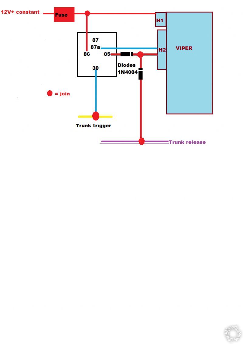

Posted: December 01, 2015 at 6:22 AM / IP Logged Link to Post Post Reply Quote howie ll
Try this:- standard automotive relay, terminal 87 not used. trunk_trigger_by-pass.png

Thanks for the reply howie. Let me get this straight.
87a trunk trigger wire from viper
85 trunk release from viper
Also can you explain what the the bypass does besides bypass lol. I mean the electrical flow and reaction if that makes sense. I'll get to it this weekend. And again thanks for the response your time won't be wasted.
Posted: December 03, 2015 at 12:11 AM / IP Logged Link to Post Post Reply Quote howie ll
It's a changeover relay 87a and 30 are connected when viper RED / white grounds the coil at 85 it opens that connect so the alarm via the blue trunk trigger doesn't see the open trunk. The diodes are MANDATORY.
