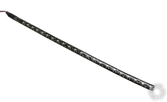

A led light strip like this

Well it didn't link it, it will scan back and forth while wired into security system when its armed

Wait until you get your Viper then the trigger wire on that scanner goes to the orange ground whilst armed (GWA) on the Viper.

Or just have it trigger when ever ignition is off
Posted: December 05, 2015 at 3:41 PM / IP Logged Link to Post Post Reply Quote howie ll
That's true, run the NEG (-) to any ignition wire, it will turn off when you turn on the ignition.
