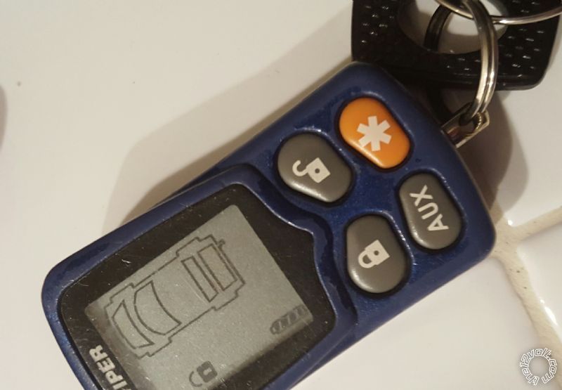

The remote shows 479v, not sure if that's the model of the alarm or just the remote.
Viper alarm -- posted image.

Go to Viper.com, support tab for owners guide for the Model 791xv. Pager 16 has info for programmable remote control features.
https://www.directeddealers.com/manuals/og/viper/G564V_07-05.pdf

This one I know from memory:
Open a door.
Turn ignition ON, then OFF.
Hold valet button until ONE beep. Release.
Push, release valet 2 times, then hold.
Should beep 2 times, LED should be flashing in groups of 2.
Push unlock on fob.
Should beep 2 times.
Release valet button.
Do nothing, and wait.
One long, one short beep. It's done.
Try it.
