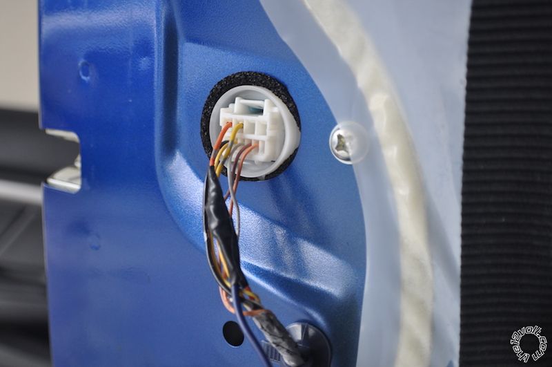

Here's the photo of the Factory lock/arm ( Orange Wire "key Lock" ) and unlock/disarm ( White "Unlock Detection" And Brown "key unlock" ). The 3 wires on the botton...
Wiring?
The AUX.2 for Lock/Window up and AUX.3 for Unlock/Window down ( Use Double - ?or only Brown wire? )
AUX.2 and AUX.3 Has Option.WHich I need to program?
2-12 AUX.2 = Validity, Lacthed, or Latch reset with Ignition? and 30-secs. Timed, 60-secs or 90-secs?
2-13 AUX.2 = Linking none, Arm, Disarm or Remote Start?
2-14 AUX.3 = Validity, Lacthed, or Latch reset with Ignition? and 30-secs. Timed, 60-secs or 90-secs?
2-15 AUX.3 = Linking none, Arm, Disarm or Remote Start?
Comfort Closure? -- posted image.

Posted: January 25, 2016 at 10:18 AM / IP Logged Link to Post Post Reply Quote triniforever
The problem with the Aux channels is that they cannot be double pulsed so if you use an Aux output to control lets say the window roll up feature you will have to hold down the button realease it and hold it down again which is very annoying and sometines doesnt work properly. For the window roll up feature you can just activate comfort closure and this sends the requires pulses to send the window up on the lock wire since its also the same wire thats controls the factory arm feature and for the window down feature you can maybe use a module called a TR7 to doubke pulse the unlock wires with an Aux output .

Posted: January 25, 2016 at 10:45 AM / IP Logged Link to Post Post Reply Quote kulblue
Ok. I program it to comfort closure 2
I hook up the aux.2 wire on lock wire(orange wire) and program it to Validity ,30-secs timed and linking arm. For window up. I press both lock n aux. Didn't work.
I hook up the aux.3 wire on unlock wire( brown wire) and program it to Validity, 30-secs and linking disarm. For window down.I need double pulse module?
