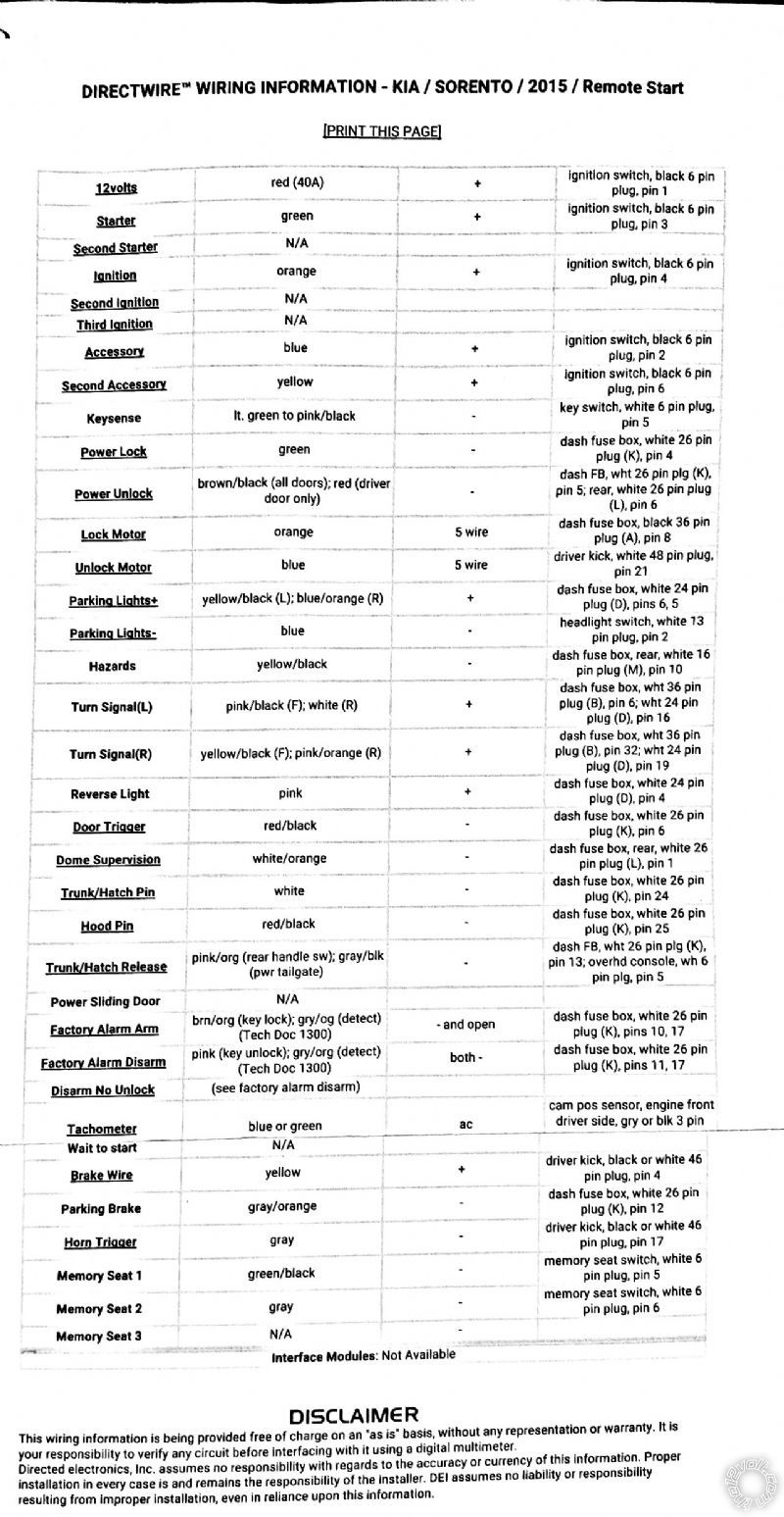

Try readyremote.com or bulldogsecurity.com. for a diagram.
brownsfan1
Copper - Posts: 65
Joined: January 28, 2016
Location: Ohio, United States
Posted: February 01, 2016 at 9:55 AM / IP Logged Link to Post Post Reply Quote brownsfan1
Here you go. http://readyremote.com/main.asp?action=select&yr=27510&product=Remote%20Start&make=Kia&model=Sorento

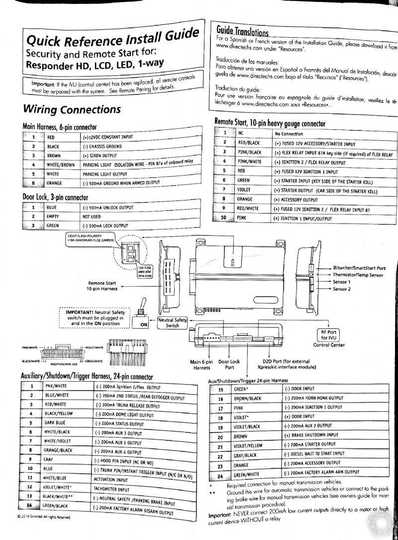

Can someone tell me what goes were? Thanks

Not trying to sound like a dbag, but if you don't know the basic wiring mapping maybe you should have a pro do it. If you don't know exactly what you are doing you can mess it up really quick, specially with a Kia since they are known to have sensitive electronics.

Okay so I went to a professional installation place it is a authorized Viper and directed dealer. He says that I need the dball2 to remote start. He said how are u going to remote start the car without the key in the ignition. U have to bypass it. I thought it was kind of strange when you told me it didn't need it.

You need a bypass if your car checks for cars with key security. Kia and Hyundai are known for not having chip key base security unless you have a PTS. My wife 2012 Sorento and my friend 2014 Sorento without PTS work just fine with out a DBALL2. I have done about six other Kia/Hyundai without PTS and I did not need a DBALL2.

Every 2015 Sorento key start I've done hasn't had a transponder key in it. No bypass required.
The above wiring from ready remote is correct for your truck.

Maybe your install place is confused. In the Dball instructions, it doesn't even list a Standard key install option, only Smart Key. In the Idatalink install guide it specifies that USDM cars don't have a factory immobilizer.
