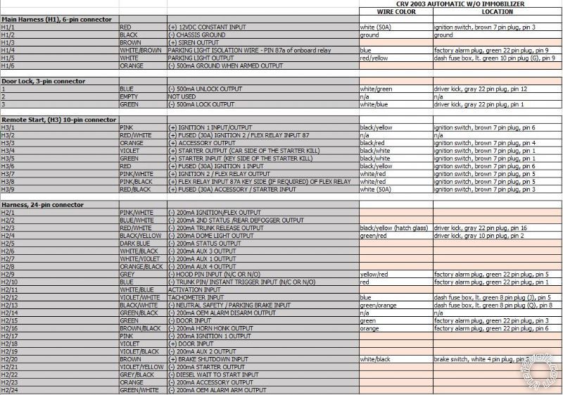

Posted: February 14, 2016 at 8:46 AM / IP Logged Link to Post Post Reply Quote modfab2502
Hi mscguy,
I hired an installer to do the job, he tried and gave up. I have no choice but to do this myself.
From all the information I could gather, I have made the attached wiring chart. I know that this is going to be too much to ask, but can you review if the attached is correct and also suggest on the missing columns / wires.
Best,
S. Gupta

mscguy
Copper - Posts: 212
Joined: November 28, 2015
Posted: February 14, 2016 at 10:18 AM / IP Logged Link to Post Post Reply Quote mscguy
H1/4, h3/8 don't use
All 3 of your fused wires on H3 connect to the white 50a ign switch wire.
Make sure to cut the starter wire. You want the key side and starter side connections of H3/4 h3/5 going to their respective sides of the cut.
Put light jumper fuse on (+).
I don't have time right now to go through the car side wires that you wrote.
Other than that, looks ok.
Make sure to test wires before connecting. Don't just assume the wiring chart is correct.
Maybe there is something weird about your car wiring. I don't know why the pro would have an issue.   I see you're in India. Maybe something is different.
modfab2502
Member - Posts: 18
Joined: February 09, 2016
Location: India
Posted: February 14, 2016 at 10:45 AM / IP Logged Link to Post Post Reply Quote modfab2502
Hi mscguy,
Thank you. I have updated my spreadsheet as per your instructions.
When you do get the time, let me know on the balance wires I am missing.
Best,
S. Gupta
mscguy
Copper - Posts: 212
Posted: February 14, 2016 at 3:27 PM / IP Logged Link to Post Post Reply Quote mscguy
It doesn't look like you're missing any. Not every wire is used for every application.
