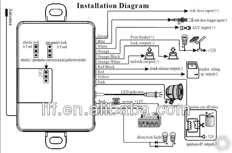

Hi, I have purchase a alarm system for my Nissan b14, all is working properly except the central locking, I have install a new actuator 2 wire( green and blue, I have wired ORANGE / black from the alarm to the actuator green wire and connect ORANGE / white to blue wire from the actuator, but it is not working. How can I get the actuator work and I have attach the wiring diagram of the module
Please help me,
Thanks,

Did you add door lock actuators to the vehicle?
The alarm has negative outputs.

Posted: February 26, 2016 at 1:20 PM / IP Logged Link to Post Post Reply Quote howie ll
Look in the relay section, add actuators, it's the exact wiring you'll need.

Posted: February 27, 2016 at 12:17 AM / IP Logged Link to Post Post Reply Quote howie ll
Yes, add the relays.
Your system is compatible with most OEM central locking systems, adding an actuator requires a system with either built in relays or adding relays.

I have an relay that I have get it together with the alarm system for ignition , its 961A-1B-12DM 40A.
Can I used this relay?
Posted: February 27, 2016 at 1:10 AM / IP Logged Link to Post Post Reply Quote howie ll
You will need two of them.
