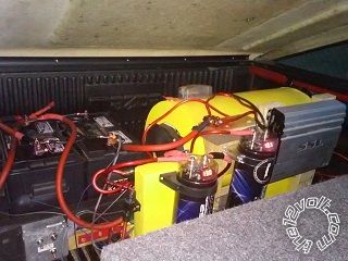

I have around 20 feet of 0/0 gauge cable with solid copper ring connectors that weigh about 40 grams each. I ran the big three, and also additional grounds from frame rails to chassis, bed to chassis, and bed to frame rail.
Worst whine Ever in 40 years - Page 4 - Last Post -- posted image.
