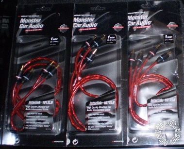

I already gave up on checking or replacing my RCA cables since they're some of the best I've used in years, and they had NO whine in my last 3 cars. Just apparently need to ground them due to something haunting this Civic. These are the Montster RCA's I'm running from equalizer to amp (2 now, 3rd when I get my sub amp):

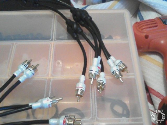

Since I'm running out of options, if moving the amp ground to another location doesn't work, I'll be forced to try different RCA cables. I do have a 6-channel RCA I paid big bucks for that I might try. Or, I have some very expensive home audio/video RCA cables that might work. They have some of the thickest outer cover of any I've seen in years.
Not so sure this RCA is any better than the 101XLN's I'm running now, but I can't afford to rush out and buy anything else right now. But this Monster Cable MicroXLN 6-channel is a start to check to see if the RCA's are the issue.
Worst whine Ever in 40 years - Page 2 -- posted image.
It's what I used in my Dodge Stratus from the head unit outputs to the crossover inputs.
