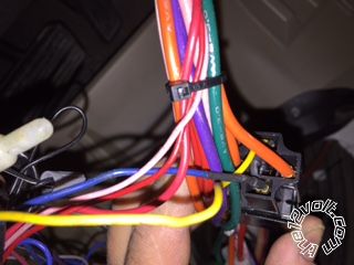

Posted: March 08, 2016 at 11:23 AM / IP Logged Link to Post Post Reply Quote bvigor
Replacing Clarion Ungo RK1 with Viper 5204 -- posted image.
This is the external relay, it has a diode connected between the 86 and 85 then a diode from 85 to a blue wire on the old alarms ribbon harness the blue wire is cut and also has 2 diodes on it. This is where a lot of my confusion is coming from.
terminal 87 has a wire that runs to the RED / white wire on the steering column harness but there is no terminal on the relay for it.
