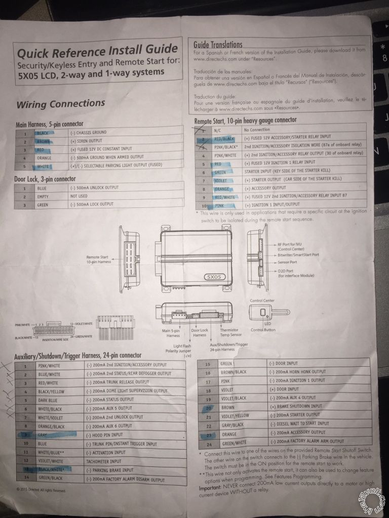

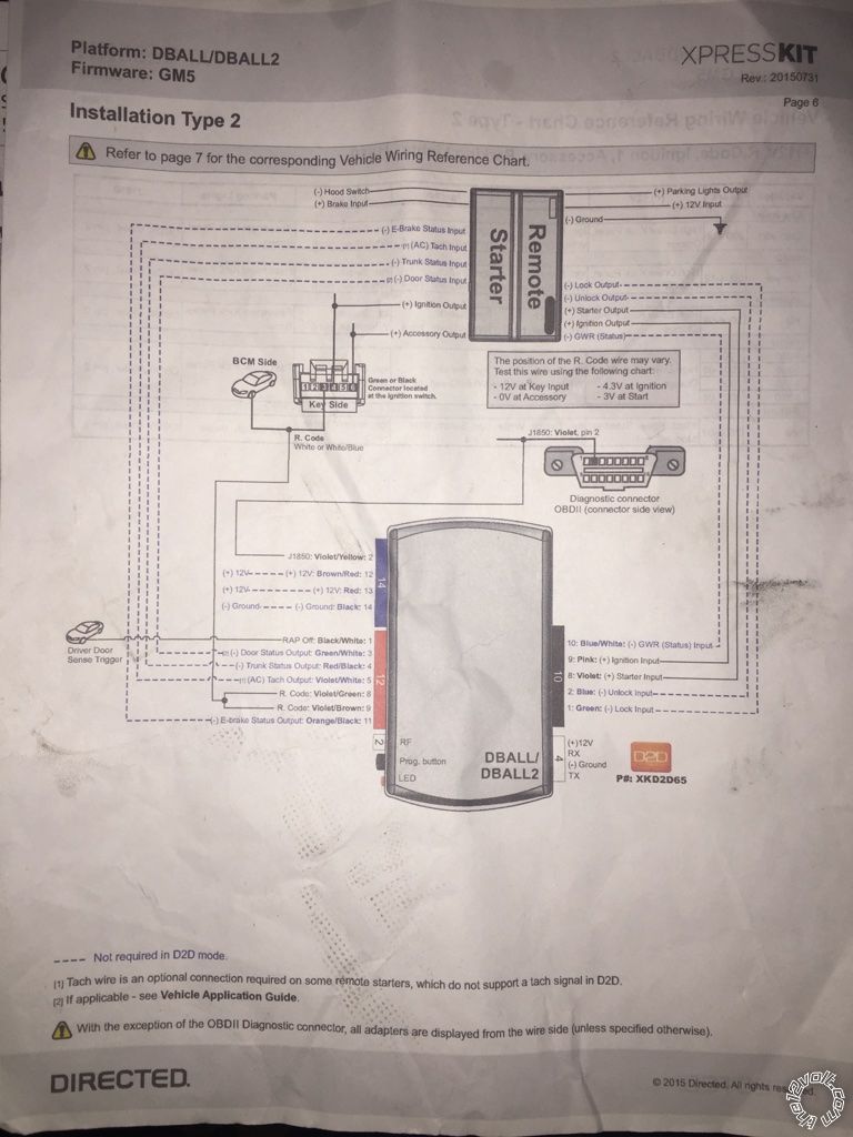

I just installed Viper 5101V and Dball2 with D2D connection and all works well except remote start.. It starts 3 times and shuts off after each start.. Error code 3 flashes Low or no RPM, I programmed Learning Tach, but not needed for Virtual Tach, which what I am doing. I even tried a w2w connection on (light blue on coil) but that made my hummer misfire). So I am trying virtual and reset that still no luck..I connected all the blue highlight and all the recommended ball2 ... also used a relay for the starter kill connected to ignition switch WHITE/ green pin 4 and starter kill works well.. So I need to figure out this Low/No RPM with virtual Tach . Hummer H3 2009 automatic

As a side note, I would not have the Starter Kill circuit connected to the H3's Ignition wire.  Bad idea for a couple of reasons.
First, don't you already have the Vipers Pink IGN1 wire connected there?  Second, you don't want to have a problem with
the Viper that could kill the H3's main Ignition circuit while doing 70 on the Interstate.  If you really want the Starter Kill
feature, use this wire :  Starter  purple (for starter kill only)  (+)    @ starter or under-hood fuse box, top, white 2 pin plug, pin 1

With the DB-ALL2, it should be flashed with the GM5 firmware.  Follow the Type 2 install diagram.  If going D2D, all of the
dashed Blue lines are handled by the D2D harness connection.  Only the solid Black lines must be hard wired.
Did the DB-ALL2 program properly ( with good LED indications ) to the H3?
