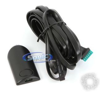

You've got your valet and status LED on the antenna but they still have separate plugs. It should still be a 2 pin plug for the antenna. You could connect it to something like this:
http://www.americanradiosupply.com/bnc-to-dual-twin-binding-post-adapter/
Then run a coax the distance you need and get an antenna that has a coax connector on it. The coax cable will give you a higher signal to noise ratio and allow you to run greater distance than just copper wire.
p023879
Member - Posts: 10
Joined: March 20, 2016
Posted: April 01, 2016 at 3:38 PM / IP Logged Link to Post Post Reply Quote p023879
Nope. Single 6 pin plug for everythingViper 5806 for enclosed trailer -- posted image.
