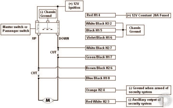

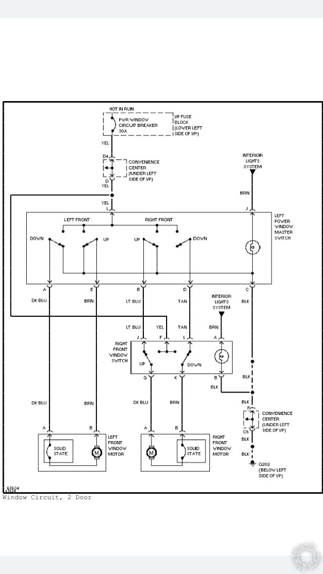

Hi everyone,
I transferred my 5706V RS/alarm system and DEI 535t window module from my 95 K1500 (5.7L) pickup to my 99 Silverado (5.3L) pickup. I obviously had to add a passlock2 bypass module and the remote start system works flawlessly. However, I'm having issues getting the window module to work properly. I want it to control the driver and passenger windows up and down so I verified the vehicle window schematic and wired it exactly as the window module diagram shows below at each door between the switches and motors. Before programming the window module, I tried hitting the switches just to see if it would work with the old programming but both windows would only roll up and down about 1 or 2 inches each way everytime I hit the switch.... "OK, so I need to reprogram" right?... but it did the same thing when I tried to program it and programming failed. At this time I questioned if the motors were working too hard to get the windows up and down so I picked up a set of new motors, installed them, and nothing changed. I put the old motors in, returned the new motors and picked up some silicon spray for the regulators and now they roll up and down just like they were new.
All wires (on my 99) rest at ground at all times, except when a switch is pressed, the respective wire switches to +12v... this is type "A" right? All wires (on my 95) rest open at all times, except when a switch is pressed, the respective wire switches to +12v.
I double checked all the connections from the window module are connected correctly... With the exception of the relays in the passenger switches, I'm failing to see why this won't work the same as it did in my 95 pickup.... at least just by pressing the switches...GRRRR! The only thing I'm thinking that could be questionable is the grounding for the window module but I have those ground wires connected to the same ground as the rest of the system. Could anyone verify that I have this connected properly?

I was wrong when I stated that the switches rest open on my 95. The actually rest at ground.

Update: I tried isolating the window module ground to a more solid point and also isolated its power wire to a separate source but the Windows still only move about 1 inch at a time.

Where do you have the module located? What size wire are you using for your power and ground?

Module is by the driver kick panel under the dash. I've tried 8 gauge for both power and ground.
