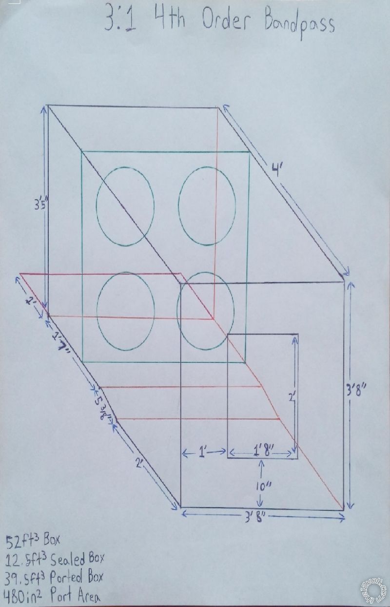

4th Order Build Opinions -- posted image.
just wondering what everyone thinks of my build schematics, does everything look right, any clue what the box will be tuned to, is my math right, ratio okay. any opinion will be appreciated. the build is in an 02 jeep liberty and it consists of 4 mofo 15s wired in parallel at .5 ohm and a 10,000 watt edge
MOFO-154X
EG1-10000D

Posted: May 27, 2016 at 4:08 AM / IP Logged Link to Post Post Reply Quote praisewaves
I'm using three-quarter inch MDF the floors will be one layer thick the walls and ceiling will be two layers thick and the baffles and portwall will be three layers thick also the subwoofers will be reversed. This is my first 4th order build and my first big build I have had two 12s two 15s and four 15s all prefab boxes so all and any opinions will be appreciated because I'm starting the 2x4 frame tomorrow it'll take me about 2 months because of my income so I have time to change things up if need be

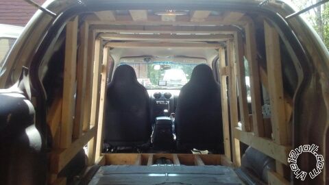

Posted: May 29, 2016 at 12:11 AM / IP Logged Link to Post Post Reply Quote praisewaves
ive got the jeep framed in. 68 views and no replies. . . i hope some people comment an share opinions but if not ill get it done either way. thanks for viewing and once again feel free to comment all opinions are welcome good and bad

Posted: May 30, 2016 at 9:28 AM / IP Logged Link to Post Post Reply Quote DYohn
I assume you are building this to compete?

Posted: May 30, 2016 at 11:53 AM / IP Logged Link to Post Post Reply Quote DYohn
When you are finished be sure to get it metered and let us know what frequency you burp.

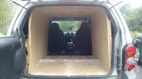

Posted: June 04, 2016 at 3:19 PM / IP Logged Link to Post Post Reply Quote praisewaves
got the walls up, coming along slowly but surely

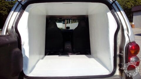

Posted: June 13, 2016 at 7:59 AM / IP Logged Link to Post Post Reply Quote praisewaves
ends capped off and outer walls painted, gotta say everything is coming along great but at the same time lol its all harder than i thought it would be anyways ill keep yall posted and in the mean time as always feel free to comment and post
