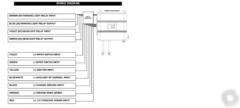

Here is the diagram.
2008 nissan versa, 545t -- posted image.

I don't see where you listed that you hooked the Brown parking light input to 12v constant.

hi lurch228 my diagram its different from your on my they listed violet/black for parking light relay input ,i get it connected to 12volts,i don't know why don't work ,thanks for your info.

Upon reading again you list the Black as being connected to 12v Shouldn't it be connected to chassis ground?
Sounds like you have the version that has the same wiring colors as the 451M has. So for positive activation you would hook the violet and violet/black to 12v constant. Other side of relay for the violet would be the Blue/Black, And for the Violet/Black would be the GREEN/ Black.
Ignition input should be connected to Switched ignition source.
