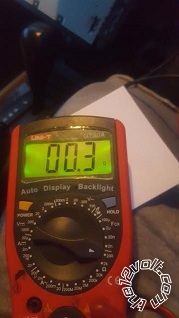

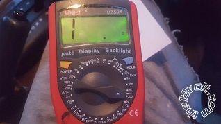

Posted: August 29, 2016 at 2:46 PM / IP Logged Link to Post Post Reply Quote red baron
so this is how the metre is setLand rover discovery 2 stereo upgrade - Page 2 -- posted image.
red baron
Member - Posts: 14
Joined: August 20, 2016
Posted: August 29, 2016 at 2:47 PM / IP Logged Link to Post Post Reply Quote red baron
the reading appear to be similar
