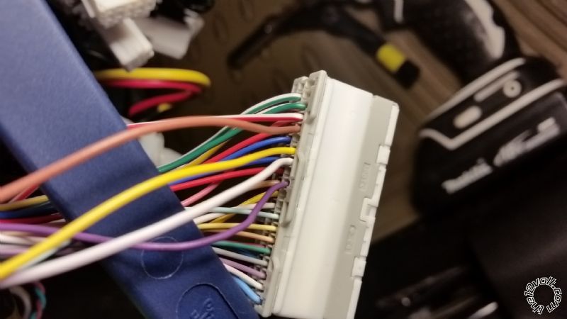

Rogue with intelli key. After installing remote start system and testing without plugging in all the harnesses on the front dash like eco, awd, tc, etc. I get all the errors even after having them plugged in. I don't have obd scan tool. I unhooked battery for 10 minutes still having the problem. Any way to get rid of theerrors?

I do a couple of 16 rogues every week, I-Key and flip key, and always test them without those mentioned switches plugged in, I never had that happen. I would recheck all your connections. Did you do 3XL? That only requires connections at 3 plugs at the BCM, very simple. I would check the plugs/pins.
Was one of your 3 neg. ignitions an aluminum wire. How did you connect to that if it was. I assume you used diodes on these also.

I used al ca and yes I used diodes on the on the ignition wires. I checked all connections and looks good. Can't figure it out. No I did regular install not 3XL.

I don't one of the ignition wire was aluminum. Should it have been?

Yes, as long as it's made by Nissan and not Renault Samsung (RSM). Did the bcm slide out after removing one 10 mil? If yes, the violet wire should have been aluminum.

I find them aluminum and copper. I just asked you to check.
You flashed the alca correctly? It programmed / cloned without any problems?

2016 Nissan Rogue -- posted image.
I tapped into the brown, yellow, and white. White was aluminum I soldered the WHITE/ black from al ca and diode isolated all 3 including the aluminum wire. The al ca programmed / cloned properly with no problems.
Yes the bcm just had 1 10 mil and slide out easily.
