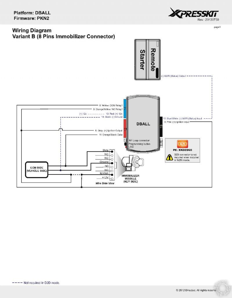

Hello again, the saga continues. I'm trying to figure out how to wire up the DBALL2 bypass module. I have the rest hooked up, but need to make sure I do the bypass correctly. It seems like almost all wires are going to the ignition wire but I can't be sure.
What is the dashed line mean between ignition on key side & vehicle side? This is a black dashed line compared to the blue dashed line which indicates that the connection isn't necessary if going to use D2D wiring.

2003 Nissan Altima Remote Start info -- posted image.
Platinum - Posts: 7,827
Posted: November 26, 2016 at 10:15 AM / IP Logged Link to Post Post Reply Quote kreg357
If you are going D2D, the dashed Blue lines are made via the DBI D2D harness.
The dashed Black line is actually a cut wire. You must cut that Red Ignition wire at the immobilizer module
connector. Internally, the DB-ALL2 will make that connection under normal conditions and open that connection
during a remoter start.
You can combine the 14 Pin Blue Plug, Pin 8 Yellow wire with the 10 Pin Black Plug Pin 9 Pink wire at the DB-ALL2 and
just run one wire to the steering column. Same for the DB-ALL2 Orange / YELLOW and Gray wires.
