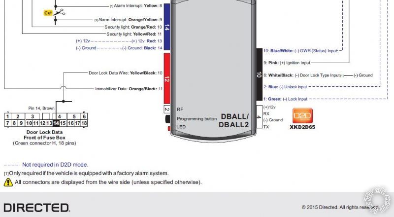

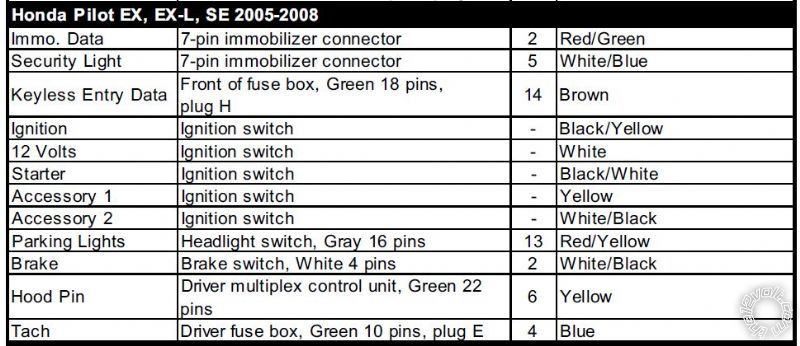

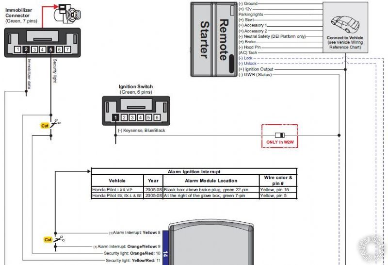

I have attached the captures of diagram that the seller gave me. I understand only solid lines show the wires need to be connected for D2D. I would like clarification on couple of things though, please confirm the following:
- If I read it right factory wire for security light needs to be cut, one end goes to H14/10 and other end goes to H14/11. Same with Alarm Interrupt wire, after cutting the factory wire one end goes to H14/8 and other end goes to H14/9.
- Keysense goes from RS GWR Status directly to the wire connected to Ignition Switch Pin 1, no diode as it is applicable only for W2W.
- Only 1 wire (H12/10) is enough for door lock/unlock input and output? And H10/6 just need to be grounded?

Posted: November 11, 2016 at 4:52 PM / IP Logged Link to Post Post Reply Quote howie ll
Exactly as you described.

Posted: November 12, 2016 at 5:07 PM / IP Logged Link to Post Post Reply Quote howie ll
1) Program as remote start safe lock solves the first problem.
2) Wire to keysense as per the diagram above for remote unlock whilst in R/S mode.
