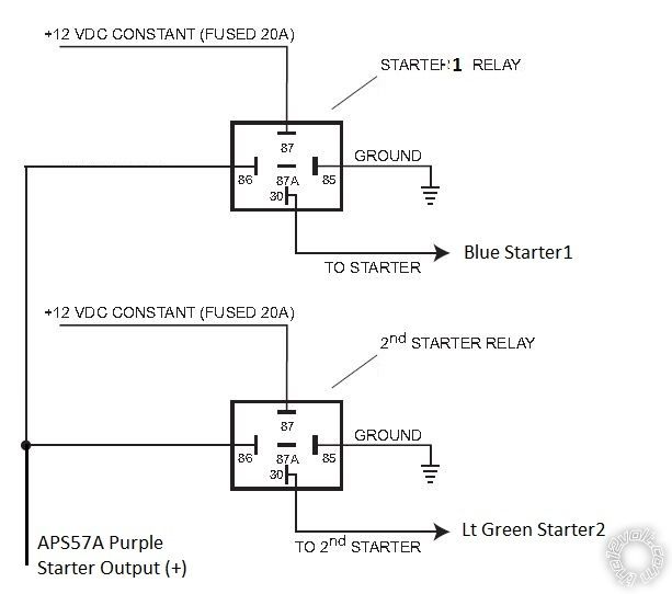

Not sure what remote start system you have. You mentioned the APS57A, which is very old & similar to the APS57C but not like the
the current APS57E model. Anyway, here is a link to the install guide for the APS57A :
http://www.voxxelectronics.com/docs/common/APS57A/APS57A_IM.pdf
It does not have the needed low current (-) Starter Output you need. The newer model ( APS57E ) does and Howards'
relay info is correct if you have the newer model.
If you have the APS57A ( or APS57C ) you can create the needed Starter2 output using two 30/40 Amp SPDT relays like this :
camry 2014 remote start wiring? - Page 2 -- posted image.
You didn't mention a bypass module for the Camry's transponder system. The key will probably have a G stamped at the top of the blade.
