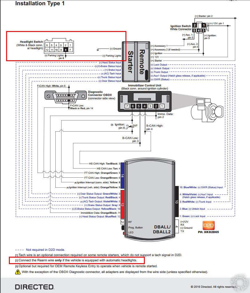

I don't see on the DBALL2 wiring diagram where the parking lights is using a relay. Installation Type 4
Note (2) at the bottom states to use the REARM wire only if the vehicle is equipped with automatic headlights

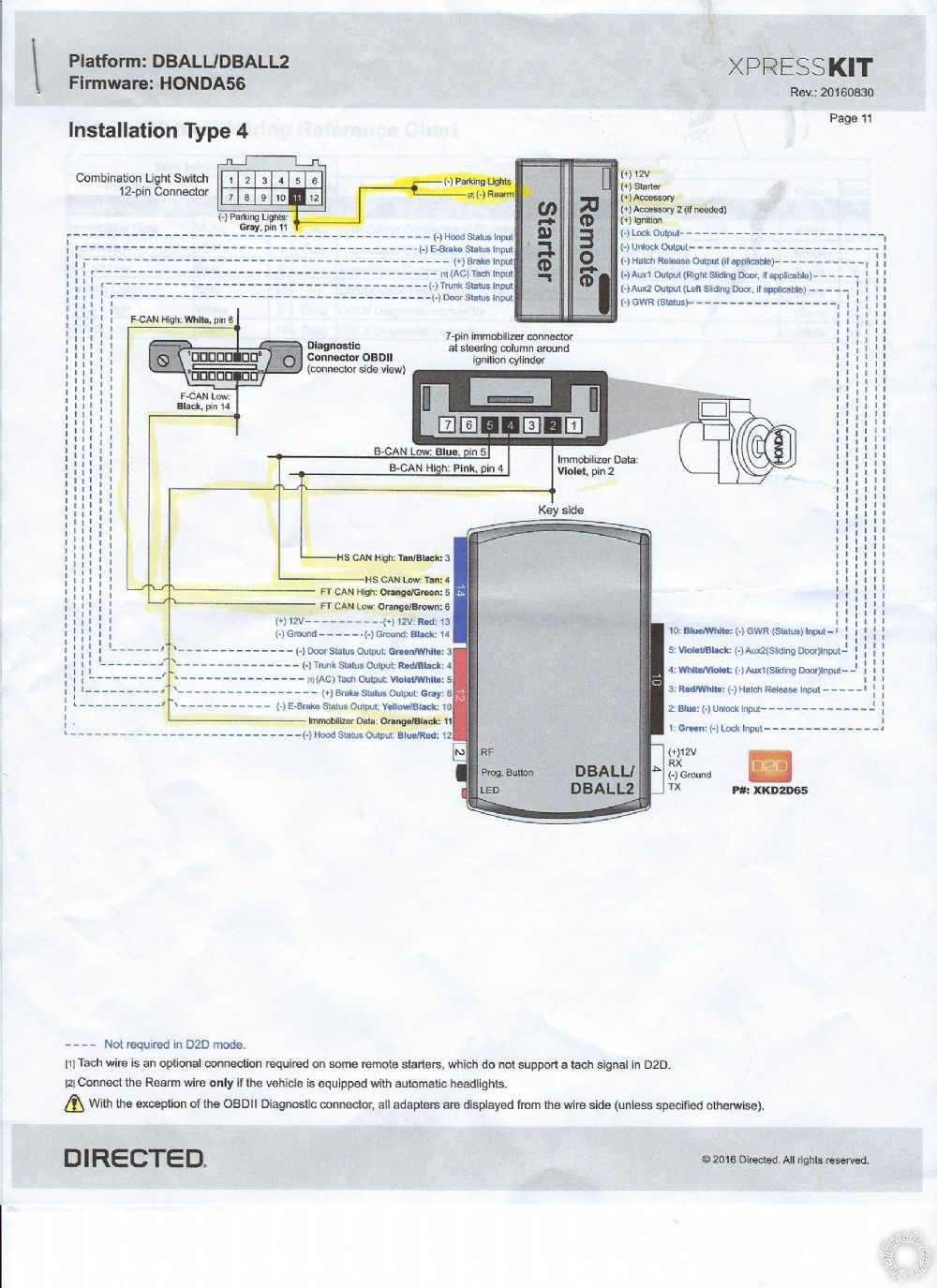

Posted: December 26, 2016 at 10:38 PM / IP Logged Link to Post Post Reply Quote jim7885
I am sorry it is on the 4806v connections it is showing the H/4 and the H/5 going to an isolation relay. I am not sure if I need a relay or which terminal to use for the Parking lights on the 4806V and which wire they are referring to as the rearm wire on the 4806v?

Posted: December 27, 2016 at 8:45 AM / IP Logged Link to Post Post Reply Quote smokeman1
Use H/5, White for your parking lights. No relay needed.
Does your vehicle have automatic lights? If so, use the (-) rearm wire from the 24 pin connector of the Viper.
Make sure to set the Viper parking light polarity fuse to (-). Fuse under the little door on top of the brain.
How and where would you hook up the Re_arm wire if you did have autolights?

Posted: January 05, 2017 at 12:54 PM / IP Logged Link to Post Post Reply Quote jim7885
I connected the rearm wire to the H/5 white parking light wire on the viper 4806v and the vehicle park light wire like smokeman1 recommended. This is how it is shown on the xpresskit diagram for the DBALL2.

Posted: January 05, 2017 at 1:36 PM / IP Logged Link to Post Post Reply Quote mduong25
I noticed your installation is Type 1, however i don't see where on the diagram it references note [2] from the bottom where is says hook up the rearm wire. So are you saying you connected the re-arm wire from the 4806V with the h/5 wire from the 4806v to the auto-light wire of the car? Viper 4806V with DBALL2 for 2012 Honda Odyssey -- posted image.

Posted: January 05, 2017 at 2:27 PM / IP Logged Link to Post Post Reply Quote jim7885
It looks like it has been updated recently, I did install type 4 and it was tied in to the parking lights. Here's a copy of my type 4 install, sorry I don't have the type 1 from before it was updated. It looks like it is missing the note (2) on the diagram. Maybe someone more experienced can shed some light on this for you.
