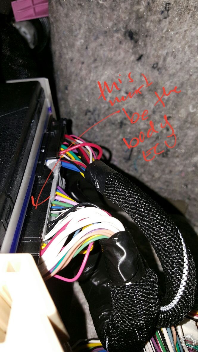

Can anyone confirm if the attached photo is the body ecu (lower plug) and if so do I pull the grey lever to unplug? I need to tap I not the door trigger wires for an alarm install. This plug is on top of the fuse box. Thx. Viper 5706v, 2017 Tacoma with PTS, Dball2 -- posted image.
cj

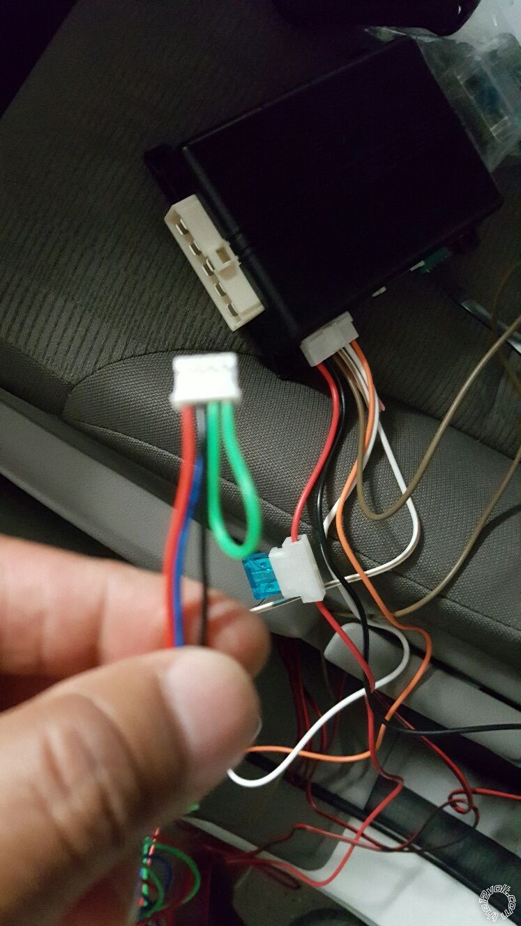

Can anyone tell me if I'm correct in that the green looped wire end of connector should plug into the Viper and not to the shock sensor. See attached photo. Thanks.

Yes. End with the loop goes into the sensor. The end with the Flying Lead goes into the control module. (You can remove it too)
