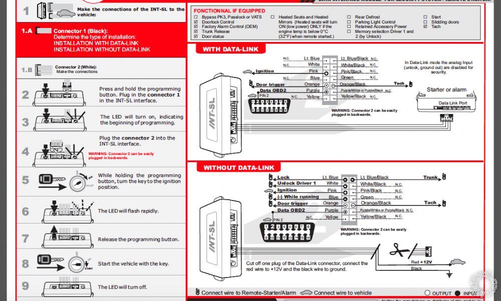

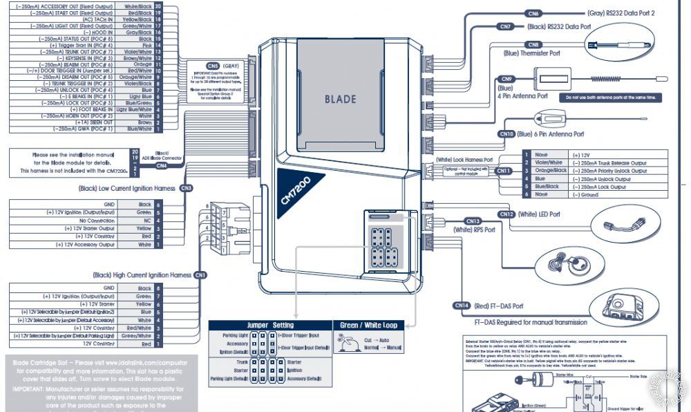

These are the wiring schematics that I have. Its just making the connection between the two besides the rs-232.
A chart would be awesome! I am a visual learner. CN5 is the harness on the cm7200 that i am working with. CN1 is already wired up.

Posted: March 06, 2017 at 8:05 PM / IP Logged Link to Post Post Reply Quote kreg357
For me, W2W is easier to visualize. It makes sense with easy to follow hardwired connections. It takes a bit longer but
provides reliable results. Here is the wiring.
CM7200-s CN5
1 Blue/White POC#1 GWA not used
2 Brown       Siren Out not used
3 White       POC#2 Horn Jeep Gray/Orange @ Steering Column connector
4 Light Blue/White           (+) Foot Brake In        Jeep WHITE/ Tan @ Brake Pedal
5 Blue/Black POC#3 Lock INT-SL+ Light Blue
6 Light Blue (-) E Brake In            not used ( manual transmission only )
7 Blue        POC#4 Unlock              INT-SL+ White
8 Violet/Black(-) Trunk Trigger        not used ( MT and alarm system )
9 ORANGE / WhitePOC#5 Disarm              not used
10 RED / White Door Trigger In (+/-)     not used ( MT and alarm system )
11 Orange     POC#6 Rearmnot used
12 BROWN / White(-)Keysense In            not used
13 Violet/White              POC#7 TrunkINT-SL+ Light Blue/Black
14 Pink       (+) Trigger Start In      not used
15 Black      POC#8 Status Out          INT-SL+ Blue
16 Gray/Black (-)Hood In to kit supplied hood pin
17 GREEN / WHITE(-) Parking Light Out     not used
18 Yellow/Black              Tach In    INT-SL+ Orange Black
19 RED / Black (-) Start Out             not used
20 WHITE/ Black(-) ACC Outnot used
For the Parking Light, get a 30/40 Amp SPDT relay and wire as follows :
Relay Pin 85 to Chassis Ground
Relay Pin 86 to CM7200-s CN1 Pin 2 GREEN / WHITE (+) Parking Light Output
Relay Pin 87 to Chassis Ground through 1300 ohm resistor
Relay Pin 30 to Jeep Yellow Parking Light MUX wire shown in Pictorial

First I'd like to thank you! this has helped ENORMOUSLY! The way that I was going to wire it was using the data link then only needing four connections to the cm-7200. It looks like you prefer the without datalink method. Second I forgot to mention the factory alarm arm/disarm. Also what kind if info/data does the INT-SL pull from the OBD2 connection. It doesn't look like a true can bus system are no hi and low can bus wires.
Thank you again for the tremendous help!

You will still need to make those 4 connections between the INT-SL+ and the Jeep. As you can see in
the Pictorial, the iDatalink bypass module also provides the Brake signal while the INT-SL+ does not.
The older J1850 connection at the ignition connector is the predecessor to the newer CAN systems. It
is a Data bus system. Typically, that connection can supply signals like Tach, Brake and Door Triggers.
It can also accept commands for Lock, Unlock, Trunk release, Arm, Disarm and the transponder bypass
data.
In the Jeeps case, with the Factory alarm, a Lock will also Arm the Factory alarm system and an Unlock
will Disarm it. That is the way the INT-SL+ handles those functions.
