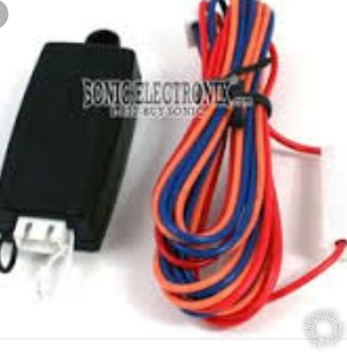

I have mounted the subject sensor inside the bottom of tge center console box on my Tacoma. Don't know why it won't trigger the alarm when I raise the rear tire about an inch off the ground. I know the sensor works when I tilt it. Do you think this sensor it's sensitive And I should mount it elsewhere? What are you folks experience? Mounting the Direct Electric 507M tilt sensor -- posted image.
