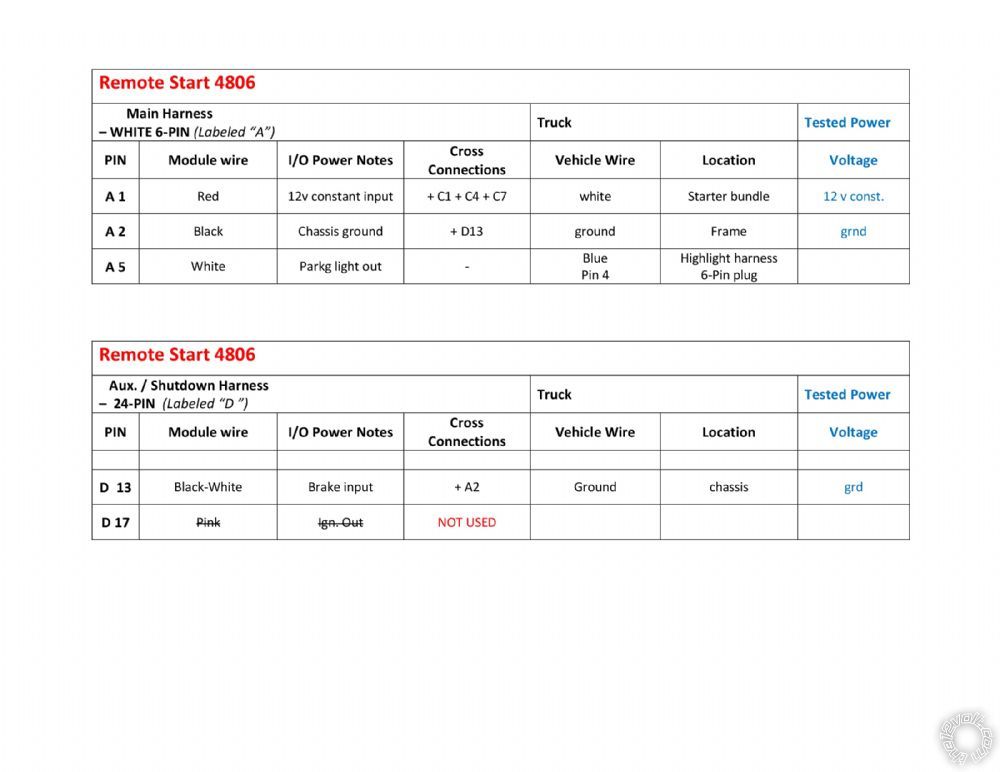

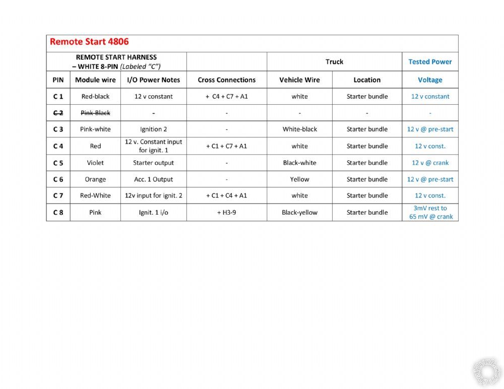

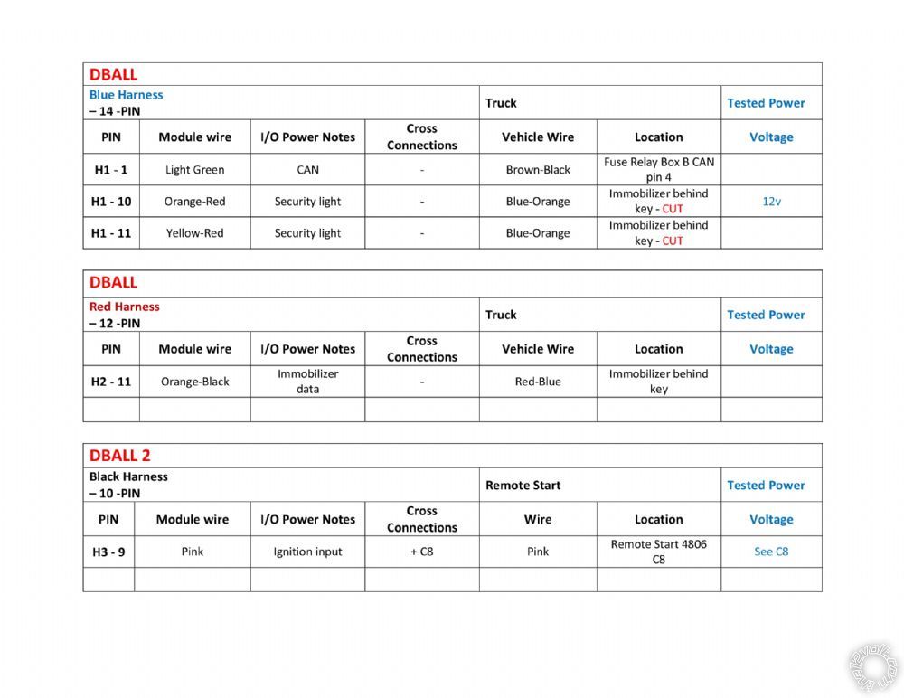

Posted: July 19, 2017 at 6:01 PM / IP Logged Link to Post Post Reply Quote larryrm
Here are my tables for connections from the 4806 / DBall to the vehicle...
Viper 4806 install problem, 2011 Honda Ridgeline RTL - Page 2 -- posted image.
