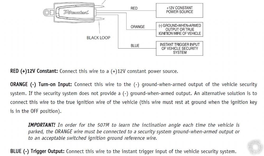

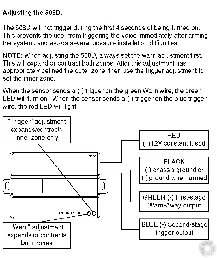

The installation manual says the orange wire is pre-wired to control the 8618 starter kill relay correct. But also that it is a ground when armed (GWA) and to install diodes inline from each additional module. (see images from each module)
The grounds are connected through a Diode from each of the sensor modules (tilt, motion) to the orange GWA as per the installation instructions.

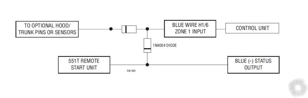

The Triggers from each of the modules and the hood, trunk and both door pins are connected to the blue instant trigger wire and I also installed a diode from each trigger individually.
I am not using the door monitor (green wire) as I only want instant (blue wire) trigger when the hood, trunk or either door is opened.
Viper 3105 instant trigger issues -- posted image.

You're completely wrong, the only one going to the orange wire is the tilt sensor.
Any other's blue to blue.
Diode all the connectors, bands away from alarm.
Also wait at least one minute after arming to test the 508D.
