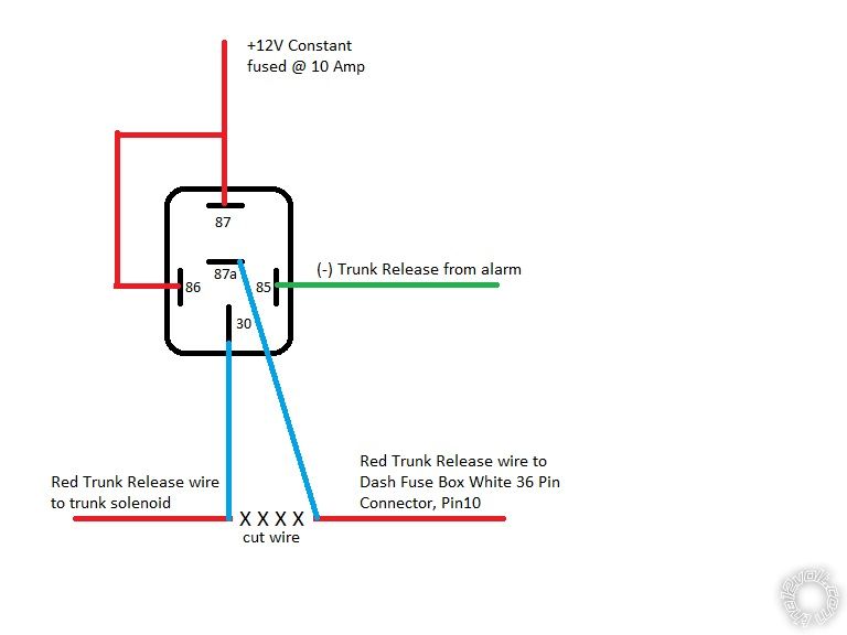

I am installing an aftermarket keyless entry into a 2013 Toyota camry. I have every thing wire up and working except the remote trunk pop. I am not sure how the trunk actuator is wired and how does it work? how do I hook up the wire from the keyless system to the car. the keyless system had a + 500mv truck / aux wire.

Here is the Camry Trunk Release wire info :
Trunk Release    RED (5 WIRE)     @ DASH FUSE BOX WHITE 36 PIN CONN, PIN 10
Here is the relay wiring. You need to locate and verify the Camry's Red trunk release
wire and then cut the wire and add in this relay circuit.
2013 Camry Trunk pop -- posted image.
