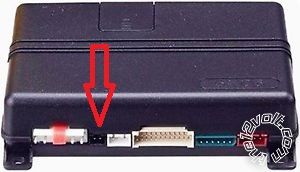

I'm currently attempting to install a Viper 5806V in a 2015 accord sport 4cyl manual. I have made all connections and connected it to a ADS-ALCA. I'm able to use the remote to lock, unlock and pop the trunk. It will not however start the vehicle. I did notice that the manual advised to install remote start shutoff switch. The diagram shows where it plugs into the 5806V but mine does not have that port. What should I do?

I would solder it, but the port doesn't exist on my unit. Shown below is what it looks like on the pictures I find online. My device just doesn't have that port. In its place is just the plastic case.
Viper 5806V missing shutoff switch -- posted image.
Posted: November 04, 2017 at 9:00 AM / IP Logged Link to Post Post Reply Quote howie ll
Make sure black/white on the 24 pin white plug is grounded.
