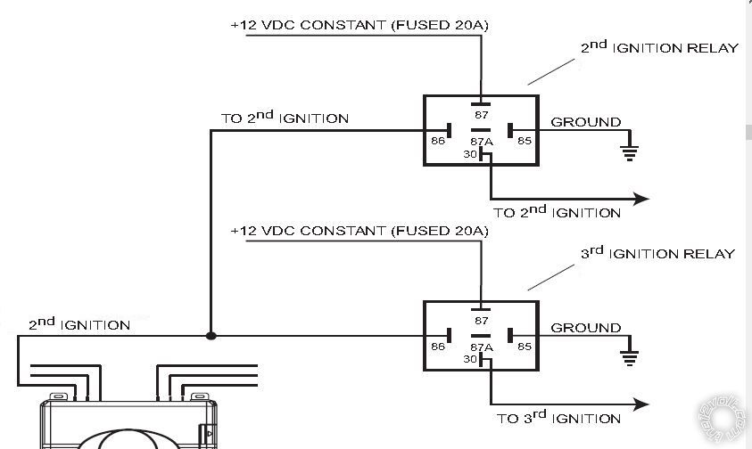

You 3rd IGN relay can also be turned on by the cars 2nd IGN without the RFID PTS system being engaged. Turn this using two
relays to isolate the ignition wires completely :
Wiring PTS System - 3 Ignition Wires, PTT Has 2 -- posted image.

Now im a bit lost. I understand most of it, but on your diagram in the left bottom, is that my ignition, OR is that the PTT system ignition 2 output?
Im *assuming* this is the PTT, ignition output 2 is the "trigger" for both relays input 86?
Thanks a TON!

Posted: November 19, 2017 at 6:17 PM / IP Logged Link to Post Post Reply Quote kreg357
Exactly correct, in the lower left corner is the add on system, similar to your PTT Yellow wire in your post.
This diagram is from a ReadyRemote install guide. They show how to create a 3rd ignition output using the
ReadyRemotes 2nd IGN output as the relay control. It does use another relay to keep a 2nd IGN output. If
your PTT system had an output called (-) 200mA Ignition or something like that, you could use it and just
one relay to create IGN3.

Okay, so your diagram fixed that issue I was having. Thanks a TON! Ive never dealt with a "dual" relay setup, now it makes perfect sense.
