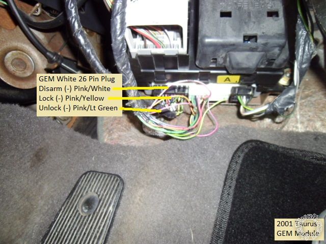

Posted: December 31, 2017 at 10:12 PM / IP Logged Link to Post Post Reply Quote kreg357
1 - I do not know how to hook up the door locks? The wires are missing that it says to hook to
Here is a photo of the GEM module under the driver side dash that shows the needed lock wires :
Avital 4105L PKALL Install 2000 Ford Taurus -- posted image.

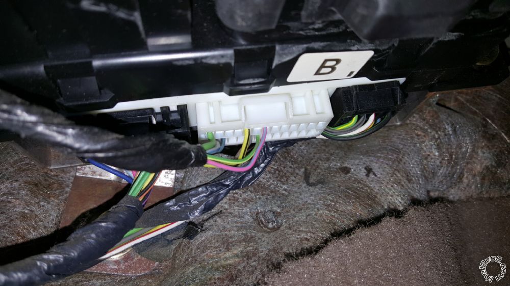

Posted: December 31, 2017 at 10:21 PM / IP Logged Link to Post Post Reply Quote craby993
Thank you for the quick response. I don't see a pink/light green or pink/yellow coming from the GEM? Can I goto the dealer to get a second key? I have a picture of the wires, just not sure how to show it to you?

Posted: December 31, 2017 at 10:45 PM / IP Logged Link to Post Post Reply Quote craby993

Posted: December 31, 2017 at 10:59 PM / IP Logged Link to Post Post Reply Quote kreg357
Yes, the dealer can make you another key. Just ensure that it is not just a clone of your current key
but a unique transponder key.
All of the wire listings I have indicate finding the lock wires at the GEM module and all of that era Taurus
that I have done had them. Your White 26 Pin Plug is definitely lacking a bunch of wires. Perhaps it's because
the car didn't come with Factory RKE. Perhaps someone else has lock info specific to your vehicle. Short of
that, you will have to test the wires going into the door via the door harness or in the Driver Kick Panel.

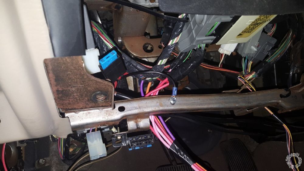

Posted: December 31, 2017 at 11:22 PM / IP Logged Link to Post Post Reply Quote craby993
Ok Thanks! I think it was rare for these to come without a keyless entry, someone said it was a rental Car? There is a screw in the cross bar for some reason. The door locks seem like they want to activate when this makes a connection. Maybe this was a add on at some point? I will post a pic. There was also a unused white connector hanging behind the bar, you can see this to the left side of the barAvital 4105L PKALL Install 2000 Ford Taurus -- posted image.

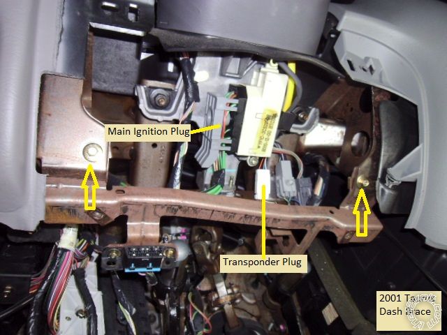

Posted: January 01, 2018 at 6:27 AM / IP Logged Link to Post Post Reply Quote kreg357
Here is a photo of a 2001 Taurus and that same area :
That Black Ground is an aftermarket add-on. If it wasn't part of your install, I would try to follow
that wire to see if it goes to some sort of black box. It's possible that it was a tracking system the
rental car company added. Just as a note, a removable cross-bar is not an ideal location for a Chassis
Ground connection. Solid, unpainted, frame in the DKP or firewall area is preferred.
As for the door lock wires, try looking for those same color wires in the DPK area.

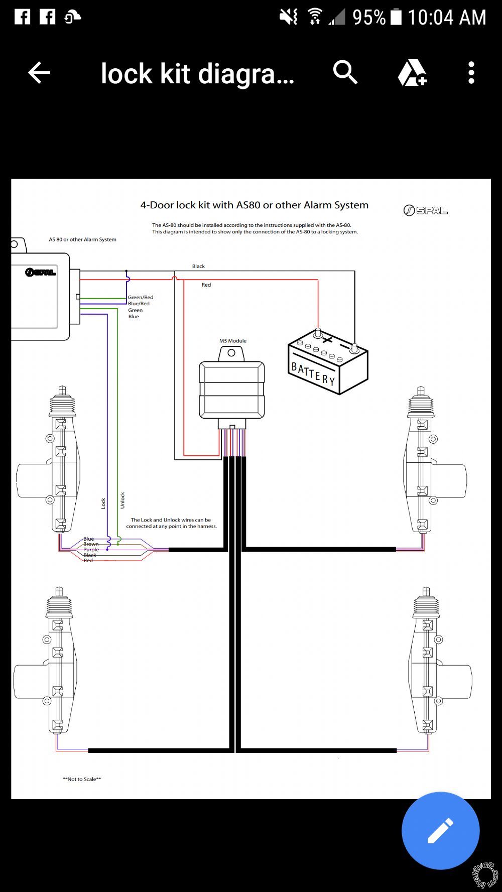

Posted: January 01, 2018 at 9:03 AM / IP Logged Link to Post Post Reply Quote craby993
It's something like this

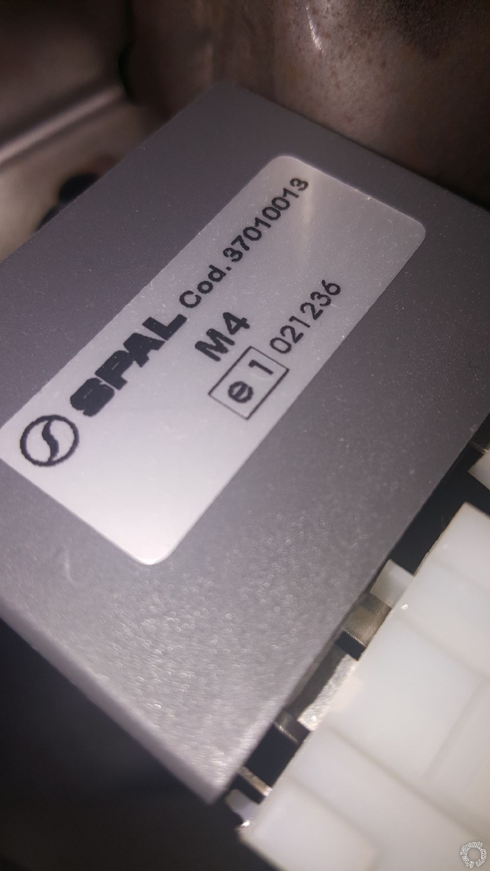

Posted: January 01, 2018 at 9:27 AM / IP Logged Link to Post Post Reply Quote kreg357
It would appear that your Taurus has an aftermarket power lock system.   I personally have never seen
a Taurus without factory power locks. If that is the controller in the car, I would move that Chassis Ground
connection to a better location. Next locate the M4 harness going to the drivers door. It should have five wires.
See if it has a Purple and Brown wire like the M5 controller diagram has. If it does have those same color
wires, you could try using a 2 Amp fused jumper to ground applied briefly to the Purple wire to see if it locks the doors
and then apply a pulse to the Brown wire to see if it unlocks the doors. If that works OK, you can connect
the 4105's Blue and Green lock outputs to the respective wires.
I believe that another forum member has used SPAL units and might be able to provide more detailed info. I'll
see if he is awake...    Avital 4105L PKALL Install 2000 Ford Taurus -- posted image.
