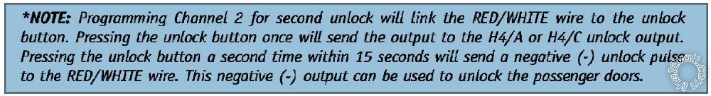

Posted: January 29, 2018 at 1:44 PM / IP Logged Link to Post Post Reply Quote wirewise
From page 19 of the Viper 150 ESP Installation Manual
Dodge Durango Unlock Sequence -- posted image.

I am sending lock and unlock to a Lt Green/Orange wire. Currently all doors lock and unlock at the same time. What I do not understand is how to unlock only the drivers door first.

Posted: January 29, 2018 at 5:12 PM / IP Logged Link to Post Post Reply Quote wirewise
Use the main door unlock output to do as IAAI said to do earlier:
i am an idiot wrote:
In drivers kick panel in bundle going into the door there is a blue wire and an orange black. These 2 wires go directly to the drivers door motor. Directechs has it as 5 wire. If you just want to do unlock, you should be able to do just 1 wire.
Then wire the 2nd channel output to where you currently have the main unlock output and program channel 2 accordingly.

Posted: January 29, 2018 at 5:24 PM / IP Logged Link to Post Post Reply Quote trey003
Now it makes sense. Thank you.
