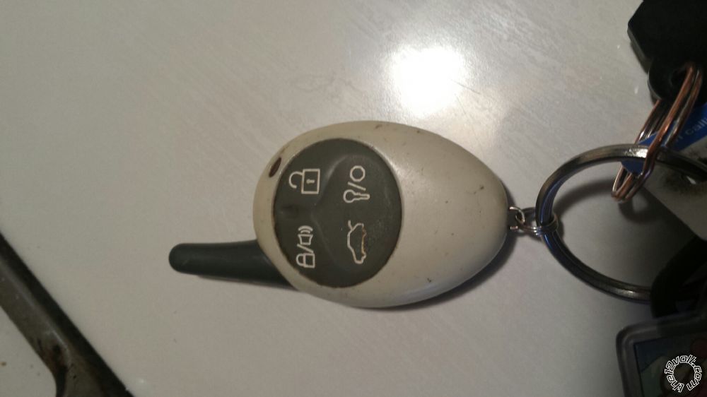

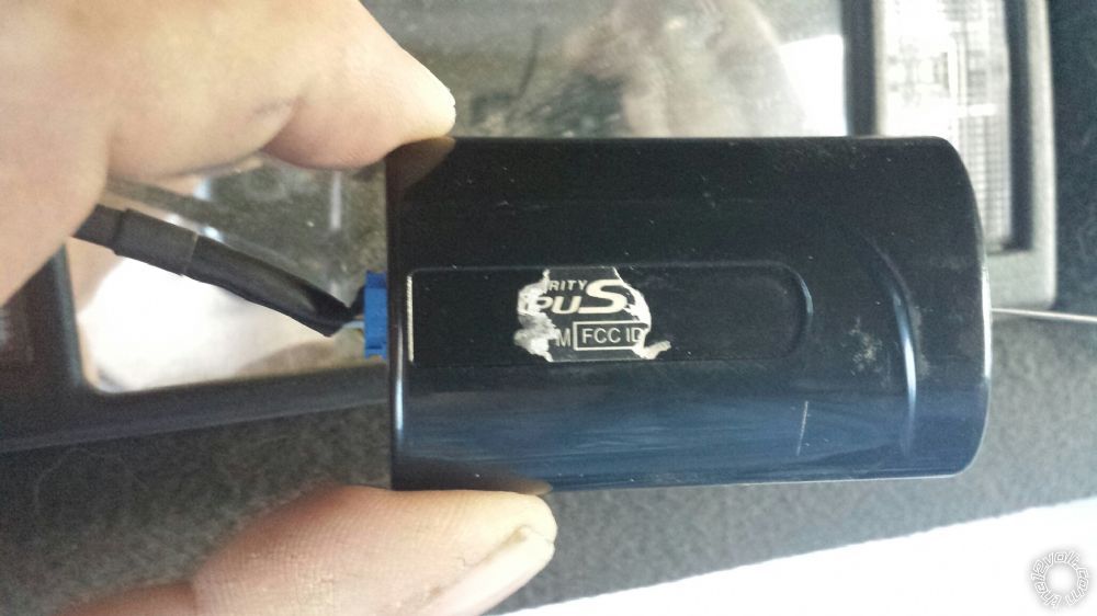

I know it compustar was wondering on model, have not gotten it in yet, had customer send pics to help I’d so I could find manuals
Any help is appreciated
Thanks
Platinum - Posts: 7,827
Posted: February 12, 2018 at 7:22 PM / IP Logged Link to Post Post Reply Quote kreg357
The remotes are probably 1W900FMR's. Decent remotes with 3,000 foot range.
They can be paired with almost any Compustar system, from the CM3000 to the latest models.
You really need to see the remote start controller box to know what you have.
