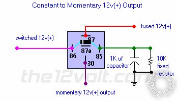

Yes it looks large. I think I have it as the dia. shows. https://www.the12volt.com/relays/relaydiagram20.html
Shorter horn chirp? -- posted image.        Shorter horn chirp? -- posted image.
I think I need to go down in size , like a 330 or 220 is that right?
Thanx for the help,
John A
John B.
Platinum - Posts: 13,723
Posted: March 05, 2018 at 7:29 PM / IP Logged Link to Post Post Reply Quote i am an idiot
The resistor needs to be in series not parallel.
The voltage going through the resistor will slow down the charging of the capacitor. The relay will not energize until the voltage gets high enough.
Leave the capacitor as it is and put the resistor between the alarm and the relay.

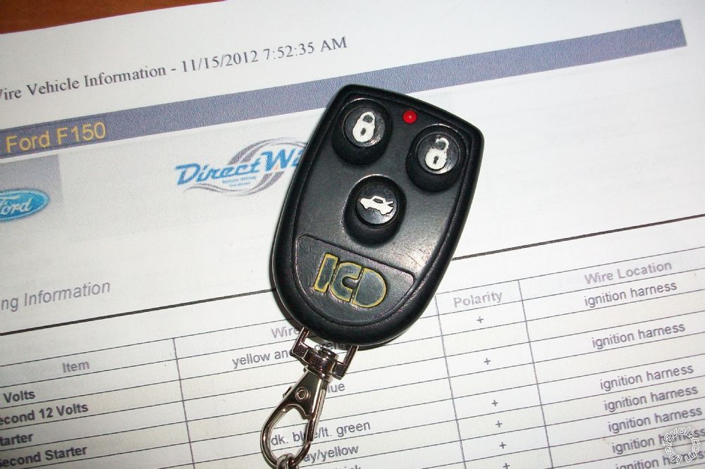

Just got my son his first truck and it had an aftermarket keyless entry in it. The horn goes off on lock for about !.5 seconds, way to long for me or the neighbors. It doesn't have a manufacture or part number on the module so can't check with the maker to see if it is programmable, but the remote does have "ICD"
on it. Does any one know this company, I don't find anything searching ICD? So that's what we are trying to do , shorten the horn chirp, it does seem shorter but not enough.

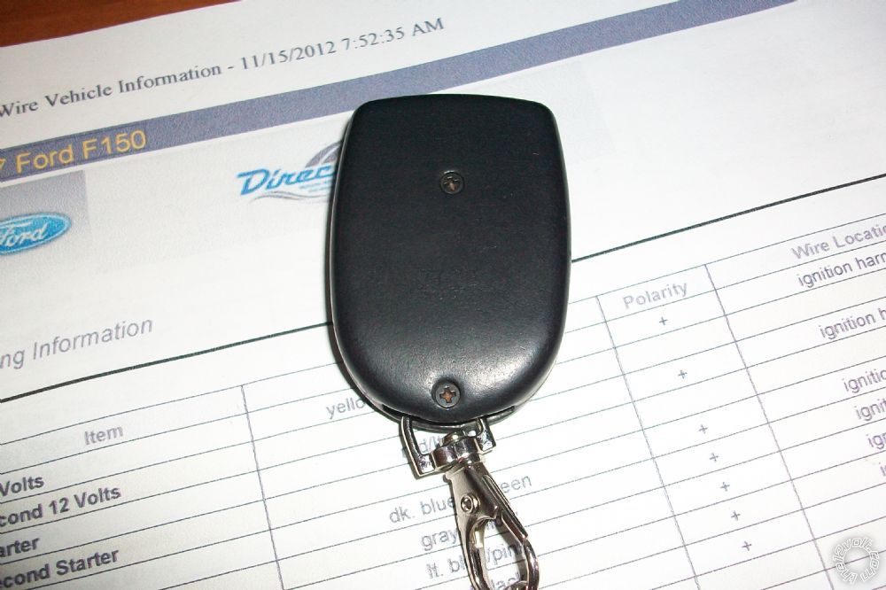

Post a picture of the remote. On the back of it is there an FCC ID number? Have you tried pressing and holding the lock button for a second or so?
ice-hot
Member - Posts: 9
Joined: March 02, 2018
Posted: March 05, 2018 at 9:52 PM / IP Logged Link to Post Post Reply Quote ice-hot
No FCC Number and no luck holding a button down either.

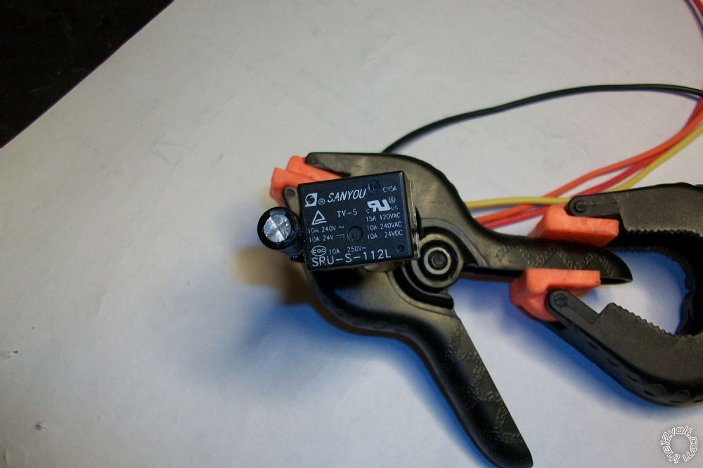

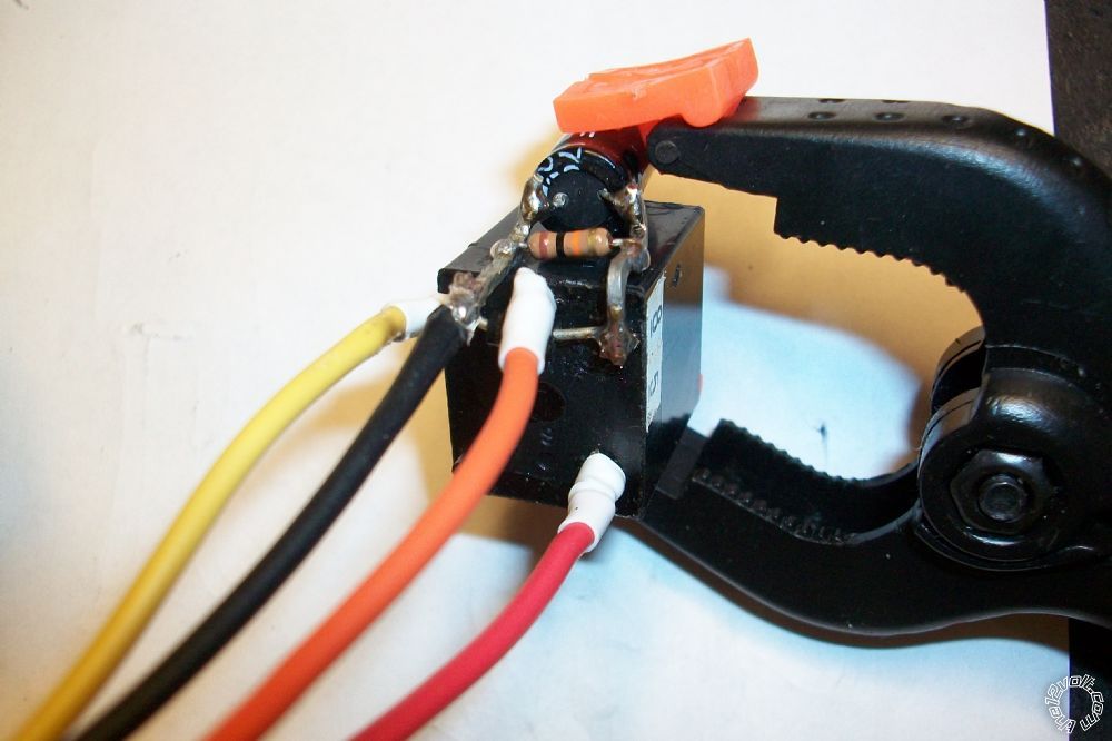

Im going to use a smaller number cap. and wire the relay like the pictured diagram.
I'll post a pic. when I have it made and u can let me know what you think.
Thanx,
JohnA
