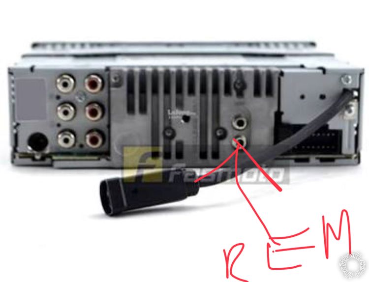

They initially supplied me with a universal SWI which didnt work because the connection for REM (hardwired remote controls, I.e steering wheel controls) on this alpine unit is a 3.5mm aux plug on the back as seen in the image below.
They then exchanged it for a universal patch lead which has the 3.5mm aux plug but then has a little 10pin harness which I can’t plug in anywhere?

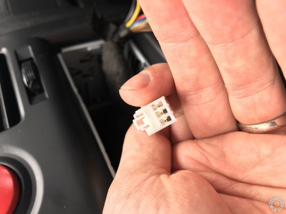

My 2011 Getz has a small harness as seen in the image below for the steering wheel controls which is seperate to the standard audio harness. Only two wires go into this harness. You can see the connectors inside the plug in the photo.
So, hoping to cut out the confusing and changing information provided by my audio dealers.... could someone help me find the correct products to connect these two wires into the alpine unit so I can use my steering wheel?

No voltage reported when connecting black DMM prong to negative and red DMM prong to either of these two wires.
With negative prong in the pink wire of the plug and the positive prong in the red wire of the plug, the following resistances were measured from each of the button presses:
Volume Up: 4.63k ohm (4630 ohm)
Volume Down: 6.84k ohm (6840 ohm)
Seek Up: 0.436k ohm (436 ohm)
Seek Down: 1.118k ohm (1118 ohm)
Mode: 2.122k ohm (2122 ohm)
What do I do with this information?
