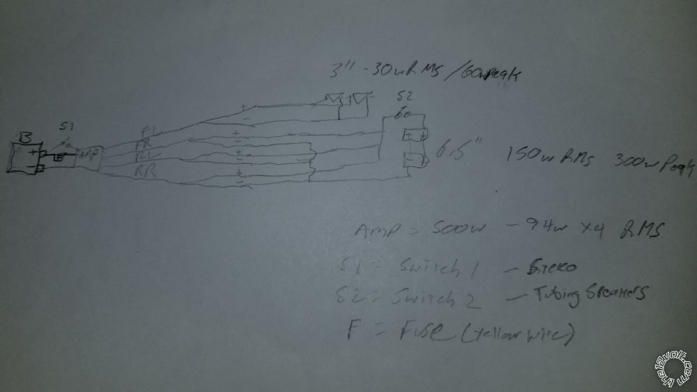

I have a question about wiring in a different formation. Would it work to wire 1 channel to both the 3 " in mono and 3 channels to the 6.5" in mono? Concerned that the 3" might receive too much power from the amp.
I've never done that before. If not, what would be a good hookup for this? Thanks for the advice!

I guess it would help if you knew the amp, sorry bout that. It's a BOSS Audio MC900B 500 Watt, 4 Channel. I'll draw up a diagram of how I'm envisioning it. This is on a jetski so stereo doesn't matter much.

Here is a diagram that I am pondering. This is purely my thinking that it will. Keep the 3" safe and give more power to the 6.5" HLCD's

Just wire it standard 1 channel per speaker, then turn the gains down on the set ( front or rear ) that you've used for your smaller speakers. KISS ( keep it simple )

Do not wire as in that diagram unless you wish to fry the amp.
