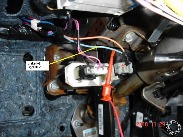

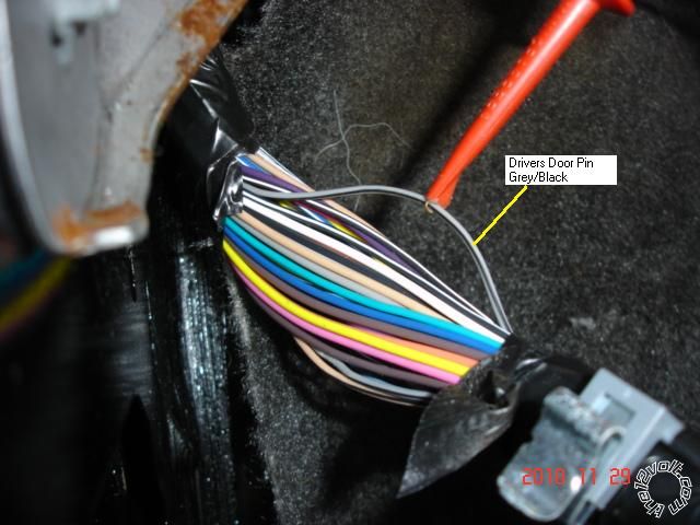

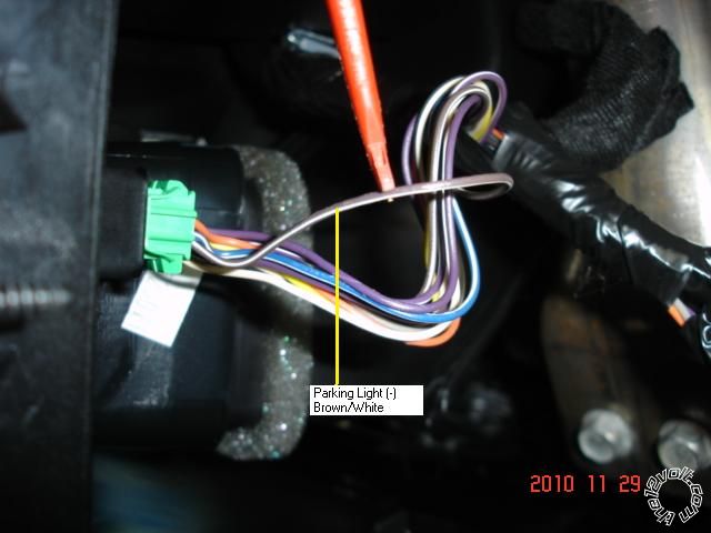

Here are a few photos of the wires :
Passlock Bypass, 2006 GMC Canyon -- posted image.
These are from a 2008 Colorado. The ignition wires are at a connector found on the drivers side,
under the dash on the inner firewall. A little easier that the ignition switch inside the steering
column.
