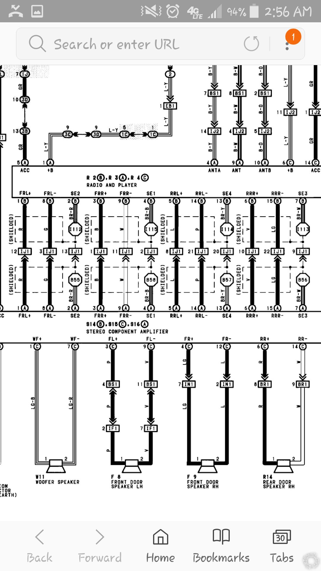

Hi, the first generation 1993-1997 Lexus gs300 with the Pioneer system has an odd looking output from head unit to the factory amplifier. Does anyone have any idea what the wires are in the shielded portions of the speaker output? I'm going to try to find a digital copy of this now to add to this post as my phone died looking for the answer and I'm currently using my girls phone. Thanks in advance for any help!! Ok I found it. The wires I'm talking about are labeled se1 through se4

I spoke with my old installer friend and he said I could just take the low output signal wires that run from the head unit to the amp and likely just solder the +/- wires to an rca style connection and just run that to my aftermarket amplifier instead of doing what I had already started which was cut the factory amps out wiring and use the output end as my input to a LOC running rca out of the LOC and then my amplifier outs to the other end of the cut factory amplifier out to speaker sections of wiring. What he said made sense but those oddly colored brown w/black, white, yellow etc wires that run in the shielded wire back to the amp have me curious what they are.
Thus I was reluctant to just cut these wires thinking there was something necessary going on there. I can't seem to find any info on those wires. So I just kept on keeping on and tapped the amp out wires to my already purchased loc.

Shoot... I just noticed that the octagonal symbols noted with letters and numerals around the shielding labeled dotted line! Apparently those are ground points. I guess these output wires have something along the lines of ground loop isolators on the two different stretches of these wires. Maybe they're run with power wires and this is to eliminate noise or something.. Anyway I think I just answered that question myself. Either way thanks guys. I noticed that a few of you looked at it anyway. Though no replies.. And hey if you don't know you don't know. Thanks again T12V
