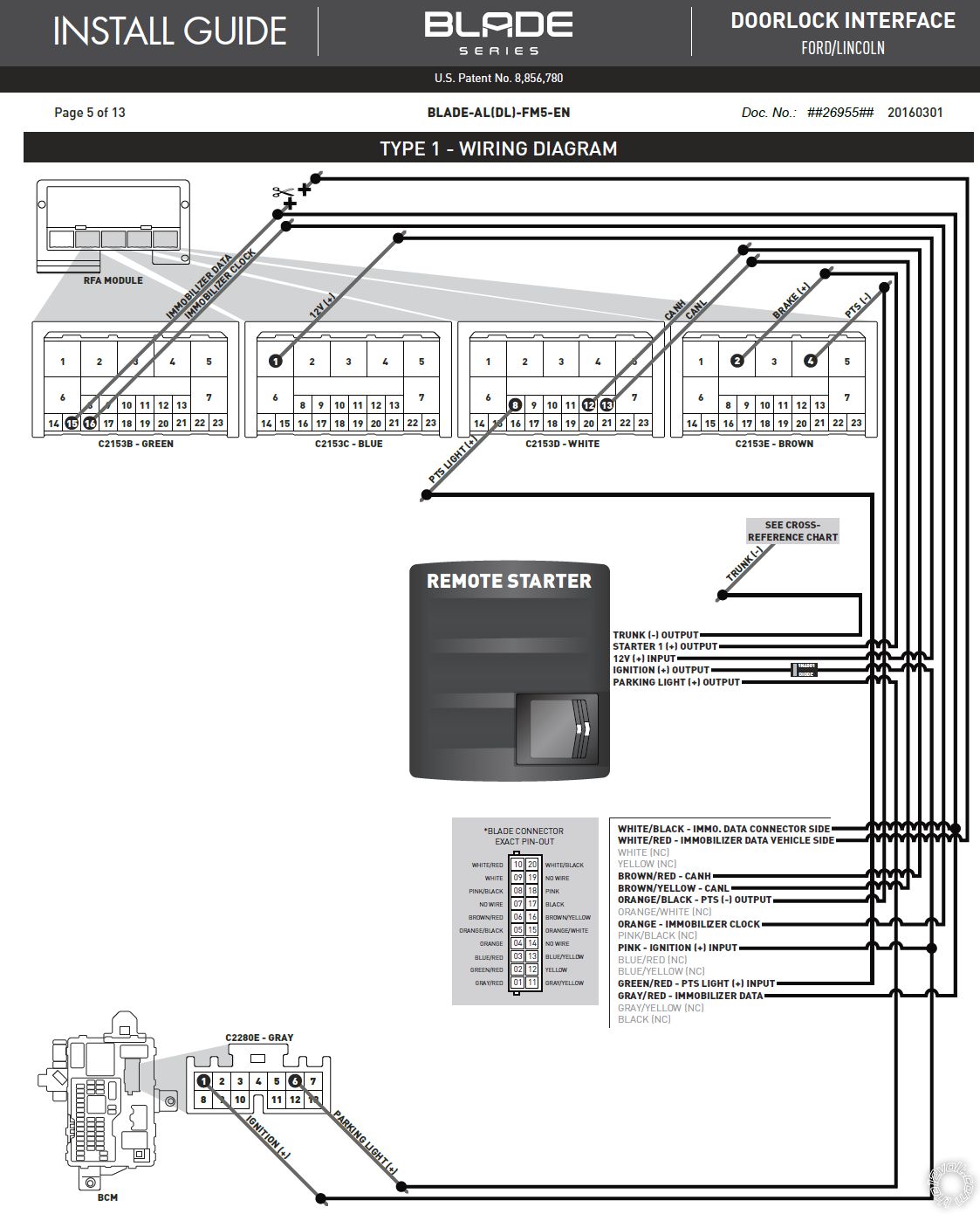

New install on a 2012 Ford Taurus with a Push To Start ignition. I have flashed the Blade AL with DL FM5 v1.6 and I'm at the part where I attach to the car, I have the original Ford FOB (without battery) in the backup transceiver but when I put the car into the on position (long push) the blue led on the blade does not go blue. I was following the "Module Programming Procedure - One KeyFOB & KLON" procedure from idatalink.
I'm using the low current ignition CN3 connector/harness. I do not have the parking lights hooked up to the car, I'm using a multimeter to monitor the output to ground. Connector C5 is not connected. The 7200 is also grounded through the CN3 low current connector/harness.
Wiring is per this:
2012 Ford Taurus w/CM7200 and Blade AL -- posted image.

Any ideas??
