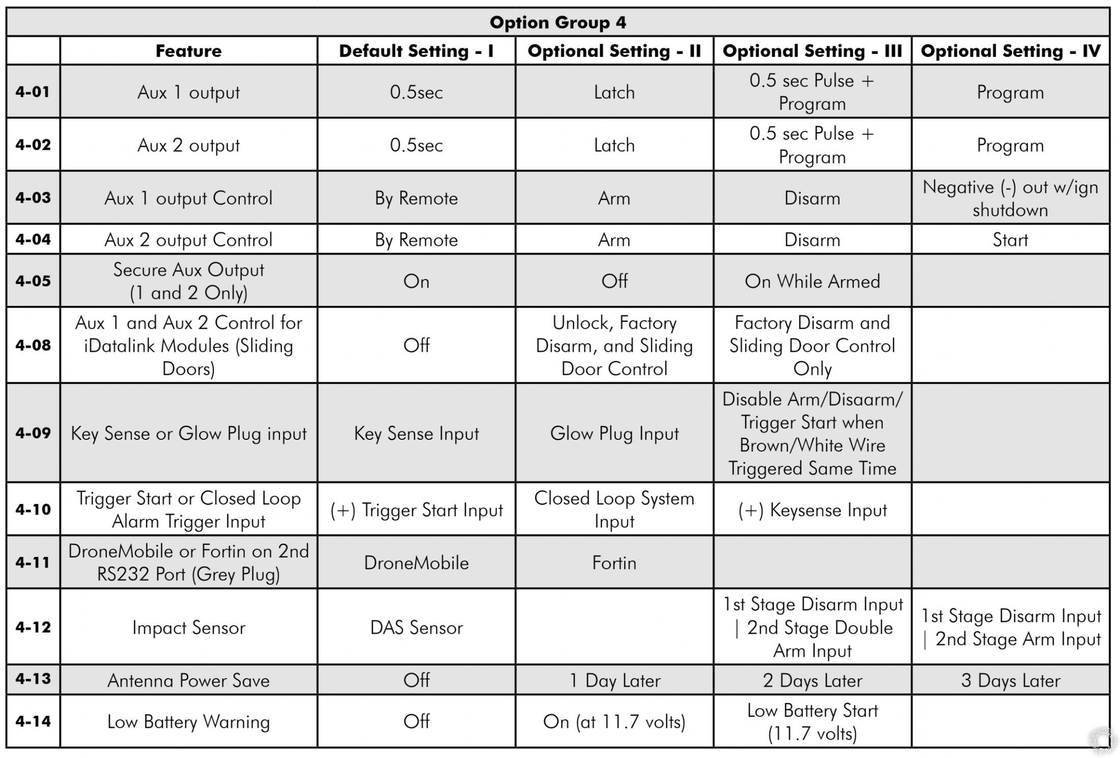

i don't normally do manual transmissions (don't care how safe they are now a days) but you need to make sure that in the menu you change 4-12 to das or option 2 or it will only see it as a impact sensor and of course make sure the das is plugged in.

According to the manual, the DAS is enabled by default. I have plugged it in, but I suppose I could test it.

I believe that the DAS is working.

Well, after hours and hours, I finally figured out what was keeping Reservation mode from enabling.... The Keysense Input. (Brown/White)
I unplugged it, and everything works great! Maybe one day, I'll get around to figuring out what happened... But for now, I'm just happy it all works.
