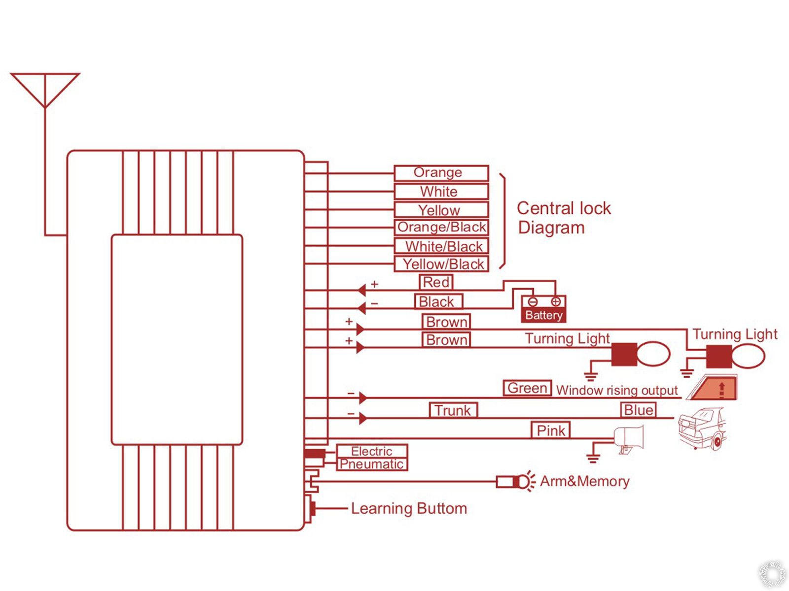

Photo of keyless entry attached now. I will post the alarm diagram soon.

I don't think this got alarm capabilities I am attaching the full paperwork from it. This is a keyless entry system only.2002 Volvo V70 Alarm Installation -- posted image.
